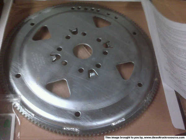

I'm just waiting on the flexplate to get here, hopefully it will be here today. If that's the case the truck should be in the shop by the end of the week.
How much have you researched your decision to buy that particular brand of flex plate?

I've done a fair amount. Some people are running them with no problems and I have found a couple that seem to be having problems with them, but the ones that are having problems can't seem to give me a definitive answer as to what was wrong with them.
I called and spoke to PRW and I was satisfied with their knowledge and the way that they described their manufacturing process. I figured it was worth the risk and it might prove to be a good source of flexplates for others that are looking to buy, but don't want to drop the $400-$500 on a billet one.
Hoping it will be here today and I will go over it with a fine tooth comb and then have my builder do the same, compare it to the stock one etc. If it looks faulty in any way I will skip it and run the stock one and report the problems we found. If no problems are found it will go in with the rest of the stuff.

Just curious, sounds like you are an informed buyer. I personally would not run a billet flex plate. Billet and flex are contradictory in my vocabulary.

Well the one I am looking at isn't billet.
Here is the one I bought:
http://cgi.ebay.com/ebaymotors/ws/eB...fvi%3D1&_rdc=1
If you google PRW they are the first link that comes up.

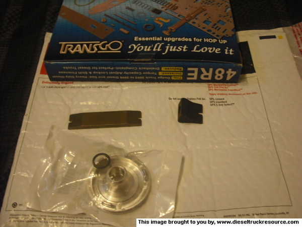

The Small parts and shift kit I got from http://www.transmissioncenter.net/dodge.htm

I got the flexplate last night and it looks like a good unit to me. Of course I don't have a whole lot to compare it to, but it is very stout and looks to be well made. I guess we'll see.

Here's some pics before it goes in the shop tonight:
