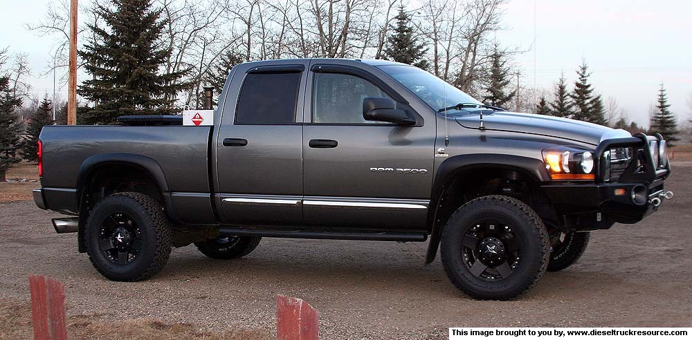

Well I'm going to order a Lorenz kit for my truck I'm just trying to decide which Sway-A-Way to buy...2.5 or 2.25? My truck does see some rough dirt/gravel roads but nothing overly extreme, I also almost always have a load in the box (2000-2500lbs) and I tow my trailered Jeep and other loads from time to time, should I get the full upgraded spring packs or is the mini-pack with my airbags good enough? What I really think I'm looking for is an upgrade to the current suspension...Any thoughts from those who have Lorenz?

If you are not driving on rough roads for hours at a time, the 2.25 will be perfect. I love mine I have the minipacks right now, but I am upgrading to the full leafs for a little better ride. If you have air bags, get the full leafs IMO.

Just wondering if the bags I have now are going to fit with the full packs or if I'll need bigger/taller bags for the extra 1.5"s....I like the way the rear rides now with the exception of some bounce at highway speeds which I think is caused by the wimpy little factory shocks not dampening enough for the load and the bags?
What about a front track bar, is the diff. centred?

THinking you would be fine with the 2.25. Unless you drive for hours off road. JMHO.
Not sure on the bag height, I could take some measurements on mine and let you know the height.
I have not done anything with a front track bar yet. Dont have a issue with centering. I am sure it is a bit off to the drivers side, but it is not noticeable.
