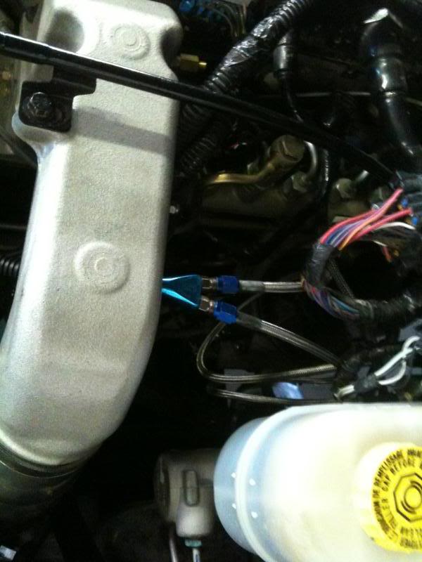

So because I had a wet nozzle for a gas motor I just used it as a dual stage dry nozzle. Spraying nitrous on both the fuel and the nitrous side. Drilled and tapped the stock horn and installed nozzle.

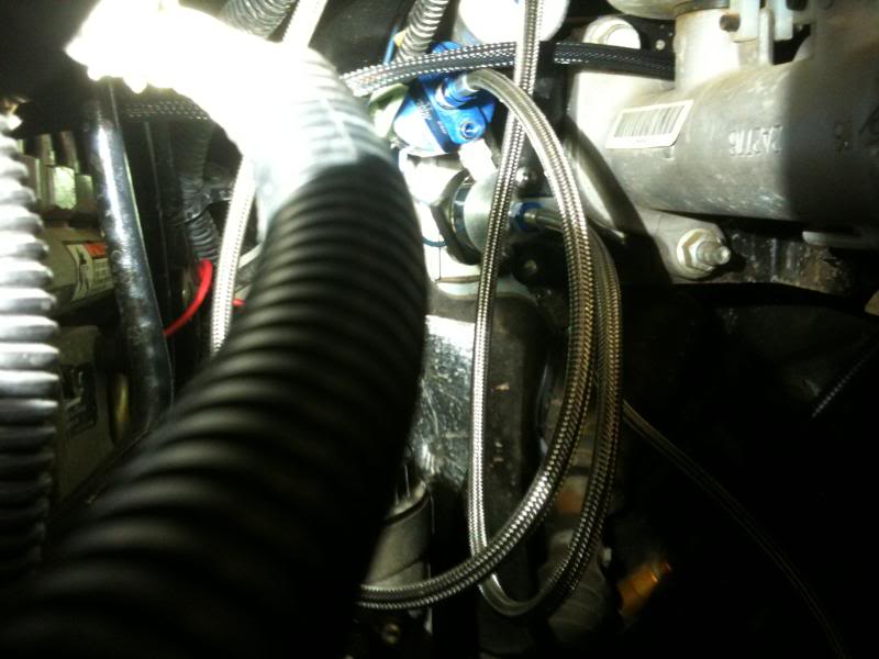

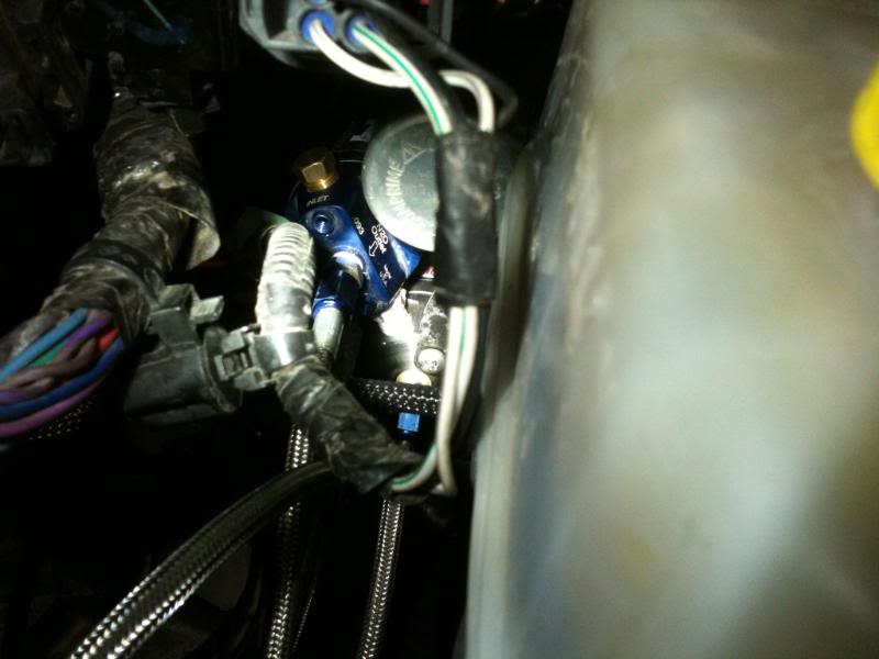

I found the perfect bracket on the brake booster to mount the noids. It is hard to see in the pic but they are well hidden.

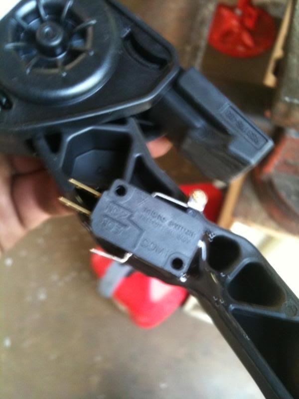

For activation I ran both grounds through switches and the from the switches they both run to a wot switch I mounted on the app. I wanted it like this because I only had to run two wires inside the cab. Not too bad for two stages of nitrous.
