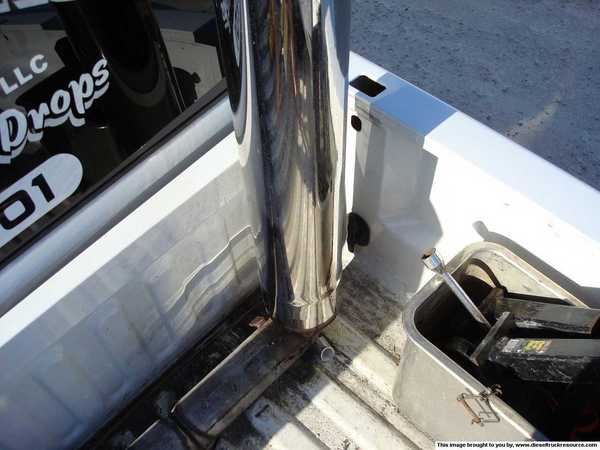

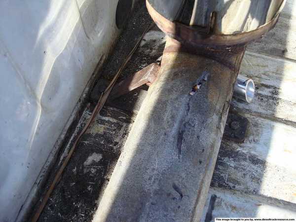

Old Sep 15, 2008 | 03:39 AM
jlibert's Avatar
Posts: 842
From: Fresno, Ca
here are some pics of mine

Old Sep 15, 2008 | 06:32 PM
jlibert's Avatar
Posts: 842
From: Fresno, Ca
I made the setup myself. I bought a 48" chrome 6" to 5" stack, 5" flex, 5" elbow and necessary clamps. I used a piece of round stock bend at a 90* angle at each end to attach to the factory muffler hangars. I welded a tab to the back of the exhaust stack to secure the it to the bed without using a clamp. I couldn't find a 6.5" holesaw, so I carefully used a sawzall to make the cut in the bed.
