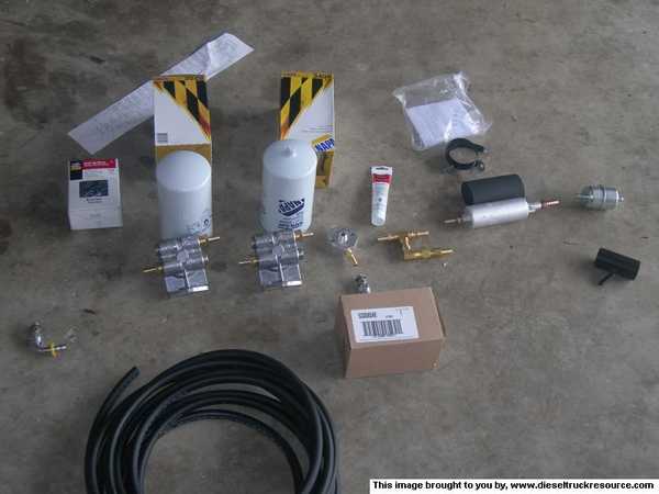

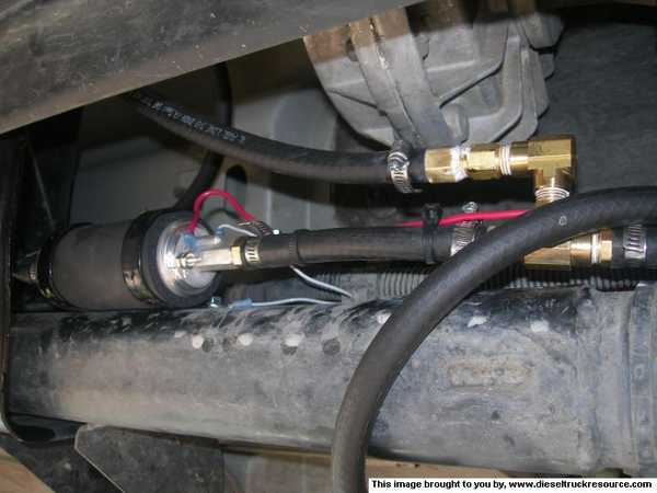

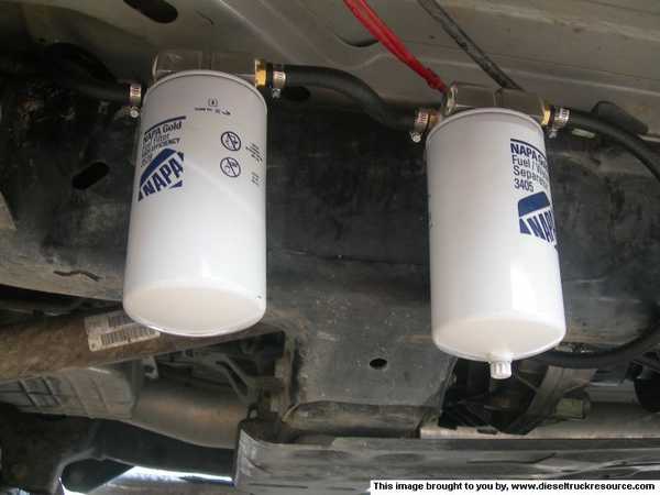

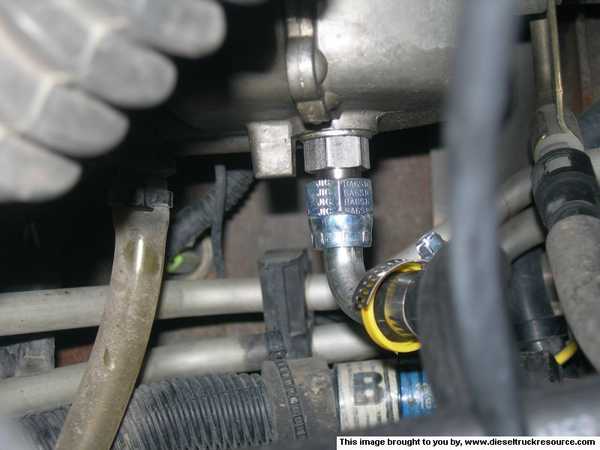

Here are some pictures of my fuel delivery setup. I went with the walbro pump to the stock filter housing, then through a fuel water separator and 2 micron filter. Then to the cp3. I got the fittings for the cp3 and stock filter from glacier.

How much did that setup cost you, did you save any more money after all the running around for parts instead of just buying the kit through glacier?

I would have to calculate up exactly how much I have in it, but a rough estimate I would say I have about $500 in it. Everything through Glacier is around $700. I just like doing stuff like that myself.

Good job, that looks real nice. I'm still trying to piece mine together. Oh, you should put some antioxidant compound on the electrical connections at the pump so they won't corrode.

How did you mount your filters? From the picture , I can not see a bracket.

Yea I was planning on putting a boot and some di-electric grease on the connections.
I mounted the filter brackets with self tapping screws.
