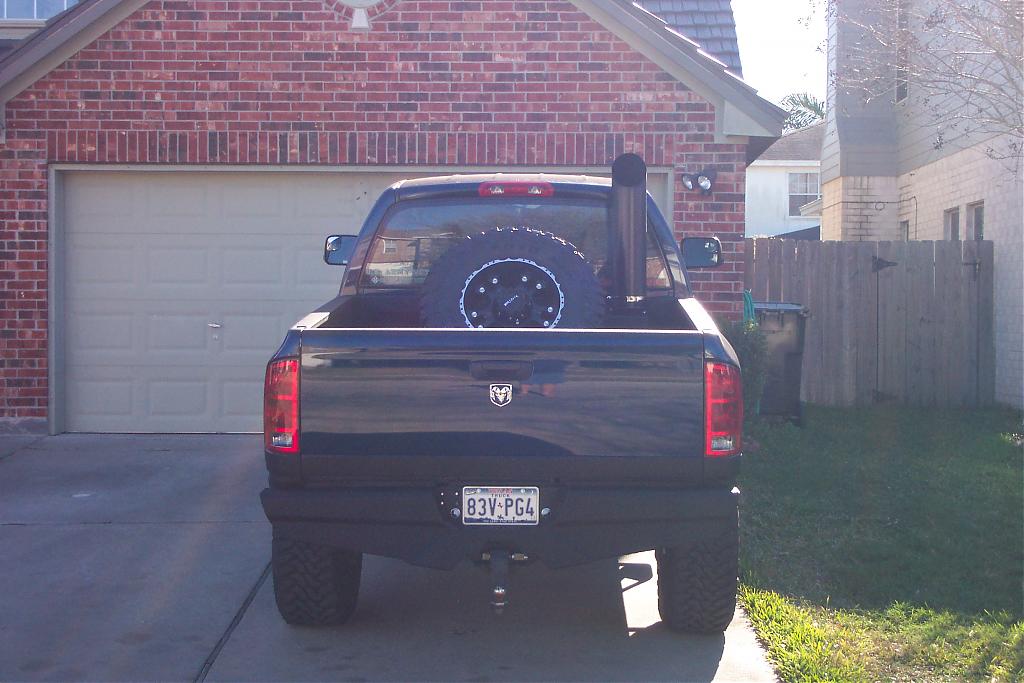

OK guys, I did a search on the subject, but I didn't find the info I was looking for. I have 35" Toyo's mounted on 18" wheels. I have a spare wheel/tire mounted in my bed because it won't fit in the factory spare tire location under the bed. I just need some thoughts on a jack. Factory jack is not really an option any more, too small, and not even carried in the truck now. I just want some input on hi-lift jacks, or should I just get a good bottle jack to carry around. I could mount a hi-lift jack in my bed, but worry about somebody stealing it. With a bottle jack, I could keep it stored in the cab, but it would have to be layed downed on it's side. Is it OK to store a bottle jack on it's side? And yes, I do have road hazard insurance on the tires, and towing insurance on the truck, but that means nothing when you're in the middle of nowhere at 2 am, and out of cell phone service range. And I find myself in these kinds of places a lot. Anybody have any ideas or thoughts? This is a pic of how my spare is mounted.
