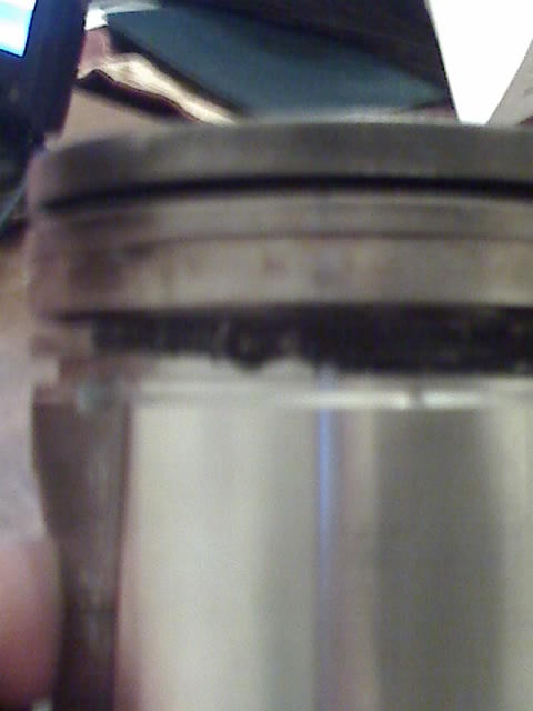

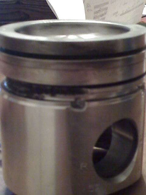

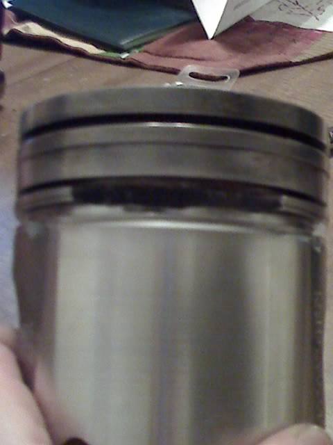

Hear is the Damage we had.
Old Dec 29, 2007 | 12:57 AM
CatDoctor's Avatar
Posts: 33
From: Peculiar MO
Hear is cyl number one out of my budys truck. The top ring was broke and the piston was broke in between the center ring and oil ring.

Ouch do you know what caused that damage.
Nick
Old Dec 29, 2007 | 11:14 AM
CatDoctor's Avatar
Posts: 33
From: Peculiar MO
By the looks of everything, we think when the top ring broke it caused the piston to prob push against it harder and cockiing the piston. Then it put pressure on the rest of the piston.

I have a photo of a brand new, never installed CR piston that has a casting defect in this area. It is a more common problem than many think. The cooling duct that is cast into the piston is the weak link in manufacturing.
The cooling duct also weakens the part and CR pistons should never be used for rebuilds on any engine other than a CR. I was appauled when I saw the use of CR pistons in 12 valve engines and this thread helps to get the point across.
