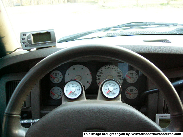

Ditto on the Isspro's and Diesel Manor!!!
Here's some pics for yah too.

We have had good luck matching the 2003+ trucks with the Isspro's and also the new DiPricol's are really close too. The DiPricol's have LED lighting and a Stepper motor operation in the pyro, costs a little more but faster reaction time etc etc.

I have the Isspro EV's, and they're very close. Only time they don't look quite right is at dusk. Other than that, they're sweet. I'd recommend them for sure. Just be sure to buy an isolator to go with the F/P gauge, and don't mount the isolator on the firewall if you're tapping your pressure at the CP3. It can be a bit loud/buzzy at times, especially with a stock lift pump. If you tap the bottom of the fuel filter housing (clean side) you won't have a noise issue.
The new DiPricol Optix look really nice, too. There's a wiring harness available that has individual dimmers for each gauge, allowing what I would imagine a perfect match to your stock lighting. I haven't seen them in person, though.
