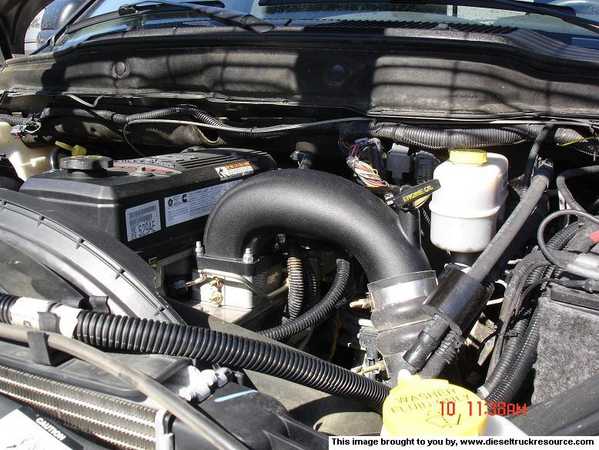

I just installed this intake horn and wanted to share my findings. Like a lot of folks on this and other sites,I have been following developments on the various intakes.
I chose the CFM because it seemed to be the closest to my idea of how an intake should be designed. The fact that it does not have any advertising molded in to it put it over the top of AFE and ATS on my list

Here are some pics for your enjoyment...
BEFORE...
DURING...
AFTER...
