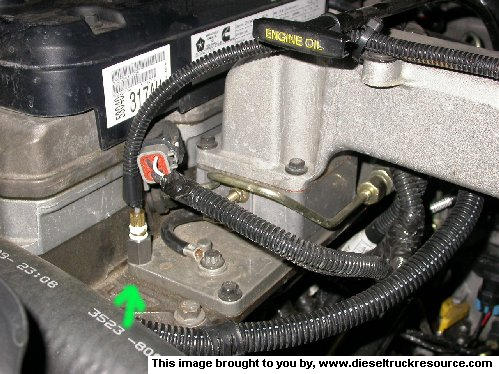

I'm sure this is gonna be a stupid question, but can someone explain what and where you tap into to get a boost reading. On my first gen I removed a fitting on the side of my block, but I dont see one on my third gen. I have all the gauges wired except for running the plastic line for the boost gauge. Can anyone shed some light on the subject or direct me to a place where there are instructions?

Piers Boost Bolt
Geno's or Piers sells a Boost Bolt for that purpose. Replace one of the intake bolts stick in the line, tighten the fitting and done. Here is pic of mine.

Or you can dtill and tap the air horn like I did.

thanks guys...a picture is really worth a thousand words!

Piers boost bolt

I also used the boost bolt from Geno's - no probs and much less permanent/invasive than drilling/tapping. Plus it came with the boost gauge kit

I ended up taping the intake horn like oops did. It was simple and I didnt want to wait any longer to have a functional boost gauge. So far I'm getting a max of 30 pounds of boost and a max of 1200 degrees. Do these numbers sound right for a completely stock truck? i'm also noticing some smoke from the crankcase breather tube underneath the truck. The truck only has 1,600 miles on it....is that normal also?
