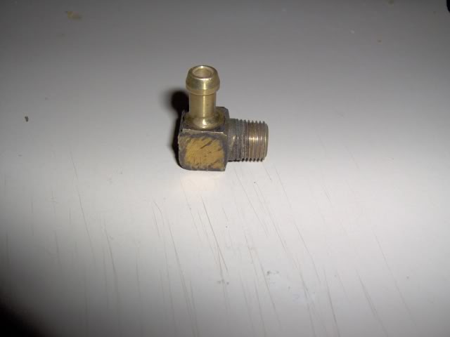

Anyone know what dimensions the boost elbow on the HE341s are? I'm lookin to find a couple replacement elbows so I can make my own adjustable elbow and was wondering what size the barbed side is? and the size of the threads are? Thanks

Its just a standard size you get at a hardware or auto parts...
1/4" hose barb x 1/8" npt thread...
Stock...
