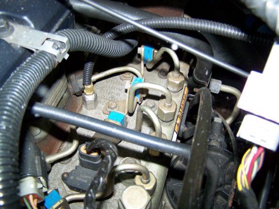

This is where Diesel Manor suggests and where I put mine. I didn't have that much trouble putting mine there. I guess it could be a little easier to put on another bolt, but this one works good for me.
