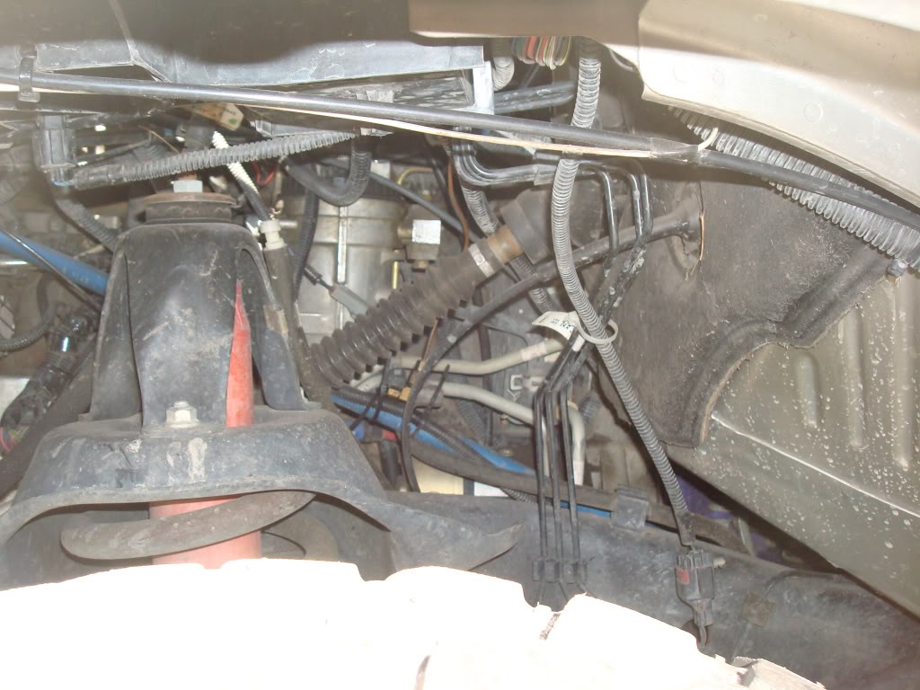

I found a Vulcan big-line kit from Geno's that upgrades the fuel line between the FF canister and CP3, so I've got that out of the way. Now I just need to know exactly what type of adapter I'll need to connect the AD line to the FF canister.

You can see the back of the canister from under the truck, or if you pull the driver side wheel well liner. Hard to see, but it will help a little to know what kind of adapter they put on. I would start another thread asking what the adapter looks like for the in tank retrofit on our trucks, I'm sure someone has it.
Here's a pic of the back of the canister from the wheel well. The silver piece is the adapter...

001-4A-1-0005-ZP Fuel Canister Fitting for 03-04 Dodge
Already headed your way Mike

I'm happy with how this turned out, plumbed through the stock filter cannister with the fuel canister fitting and Geno's big-line kit to the CP3. I feel like I'm getting all the filtration and water seperation I need, and I'm no longer worried about how much fuel is actually getting to my CP3.
