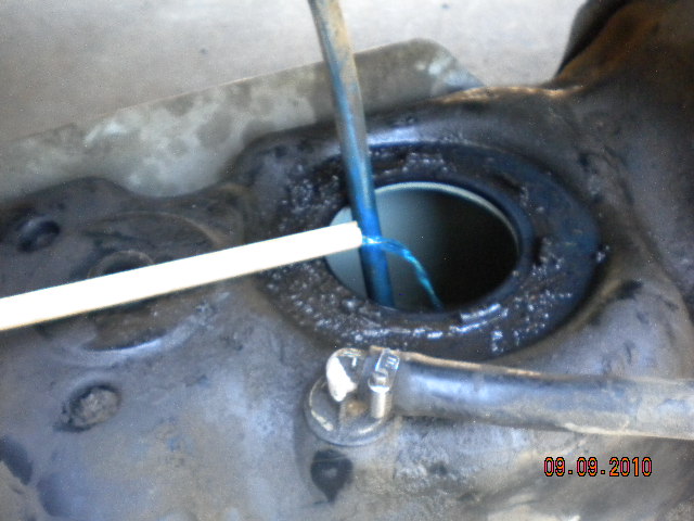

Here Are Some Flow Pics AND YES THAT IS THE SUCTION TUBE. I STUCK IT ON THE END OF THE OUTPUT TO MAKE SURE IT DIDNT HAVE A CRACK IN IT THAT I COULDNT SEE.

Sorry guys for the disappearing act. I have had continuous problems since I put this thing on. It always had an air sucking noise and over time they would get so loud it was hard to hear the radio and then eventually stop pumping. This time was the last straw. I am sick of rolling my big a around pulling the tank on this truck for the 6th time. I put a new factory lp back in this time so if it stopped working or something happened I could just switch back for starters. Then for the second time I changed all the standard fittings and hoses. It still had the same sucking grinding sound as they all did but I wasn't giving up. The only thing I never changed was the 45 that was sent with the unit on the pump side. I looked it over every time and it looked fine Nor was it out of shape. Still sucking air and wouldn't pick up fuel very fast. The only thing left was that fitting so I cut it off and put a standard fitting on and stuck the hose in the tank. I almost passed out. The pump got quiet and started pumping like it supposed to. I put everything back together and it's the first time since I owned the system that I can actually hear inside the truck and people don't look at me like I am driving a piece of junk when I stop to fuel up. That one fitting has been the fault of 3 pumps and I now realize it has been broke since new. I have looked the fitting over with a magnifying glass and it has no cracks that I can see so I duno. It shocked all of us...I had no idea these things was so quiet. Works great and ad took care of me. And yes I feel stupid but the mechanic said man you just have crappy luck. I told him if you think this is bad let me tell you about my turbo.
