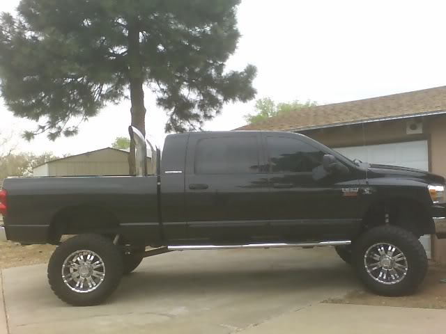

I think this is the only side shot i have without the sun shinin.

Sweet rig man. The fronts usually aren't too bad, it's the rear with that gap, kinda gets me, I don't know why. Another thing, your steps help hide the frame too, and if they are mounted up 3" to match the body lift, then thats a great way to hide everything. Your's is very well done and clean, an exception to what I've seen through out the years. Nicely done. But for me, on a straight axle truck, its all suspension lift.

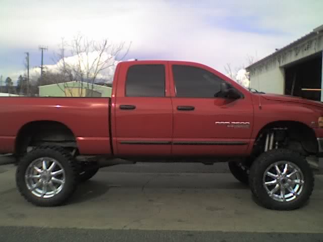

a friend of mines truck with a 6 inch superlift and 3 inch PA body. These are 38s.

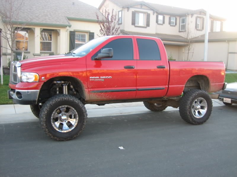

here it is with 37s and a 2inch spacer up front.
