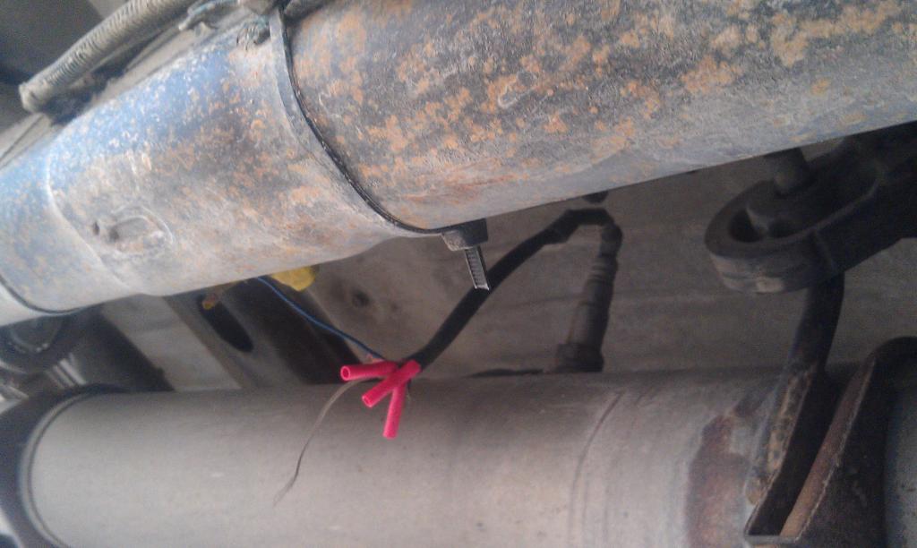

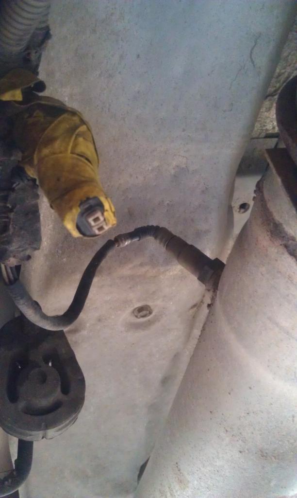

These are the two sensors on my exhaust, along with a plug that is tped yellow for some reason, but, not connected to anything or anything in the area to connect to it.

I'll try to find time tomorrow to have a look see at my exhaust tomorrow. quite possibly the best advice I can give you is to read a post in the high performance and accessories section written by Blake Clark.
find the link to it here: https://www.dieseltruckresource.com/...t-t273345.html
it is your best bet to help answer the questions at to what may be what, the 4th gen 6.7s are the same exhaust so digging around in there cant hurt haha
