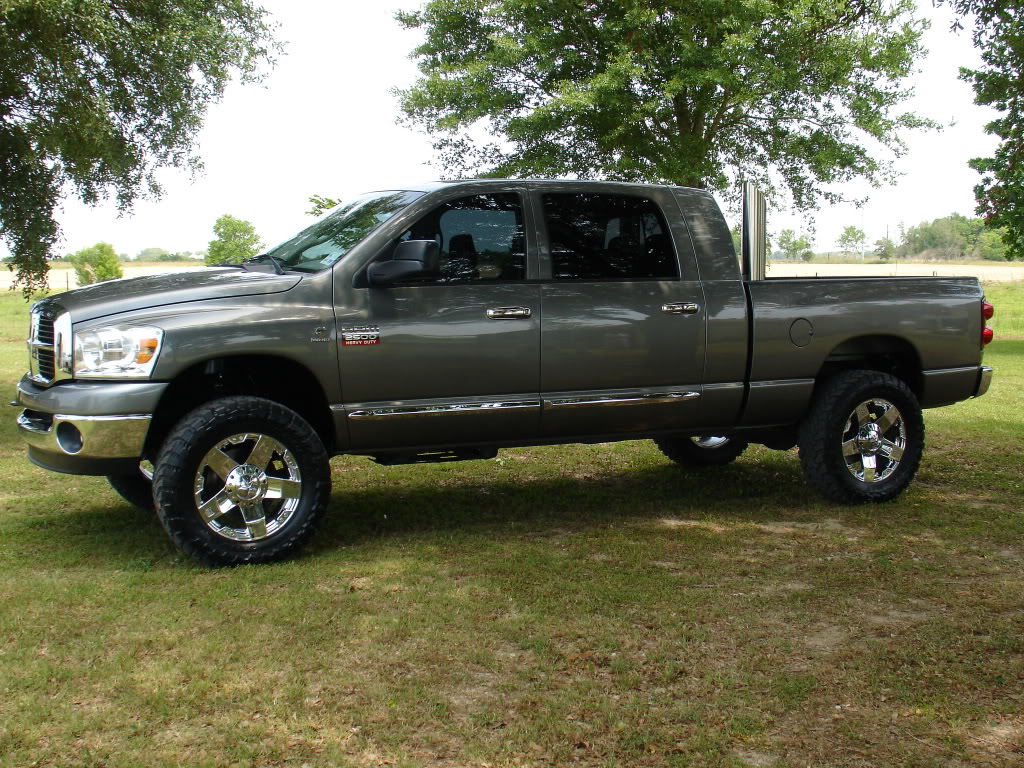

No Problem Sammy, here are a few shots of mine.
Sans stackus...
Next to the Worm's '10
Thats 35's Open Country MT's
Got right at 12k on em and they are just starting to show any signs of wear.
FYI Dad put a set of BFG KM2's at the same time I did, he has a tad over 11000 on em, and they look about half worn. They pull good but he is really unimpressed with the milage. He cant wait to get a set of Toyos on his truck
