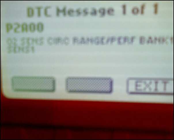

Alright boys another one for ya... Got rid of the po131 code. Dealership replaced the o2 module and also the o2 sensor. Everything was going great with no codes. Seems the dealer wasn't testing the truck with the exbrake on though. As I was taking her home I hit the switch before coming to an intersection while rolling about 60mph and **** if the CE light didn't come on again. The dealer put 25 miles on the truck and didn't get the code due to the fact they didn't use the brake. :thud:
Here is the new code:
Says P2A00 o2 sens circ range/erf bank 1 sens. Anyone ever had this code? Any info would be great !!:thumbsup

I've seen the p2a00 code. I think it's really a version of the P2000 issue. The dealer cleared my p2a00 and told me the starscan didn't show an active code but within a week I started getting P2000, which didn't show on the odometer, only on a code scanner (odo just said "done"). It became very repeatable and would come back on within a day after I cleared it with the code scanner. I took it in and they reflashed it. Apparently they have something new for the P2000 problem. It's only been 2 weeks but the cel has stayed off. Maybe they've got it finally.

I just got the P2A00 code and cleared it. I've driven about 125 miles on the highway and haven't received anything. I've had my CEL come on sproadically within the first 8K miles but didn't get one until yesterday (16K miles). I've learned to deal with the CEL and bought a scanner just to clear it. If the CEL comes back on with the same code shortly after clearing it, that's when I bring it to the dealer. It's my first diesel truck and I intend on keeping it. I don't do any towing and I've never loaded it down. I plan to in the next few years though.
