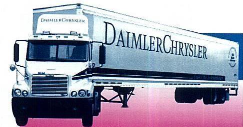

Perhaps I should clarify when I say "work trucks"...
