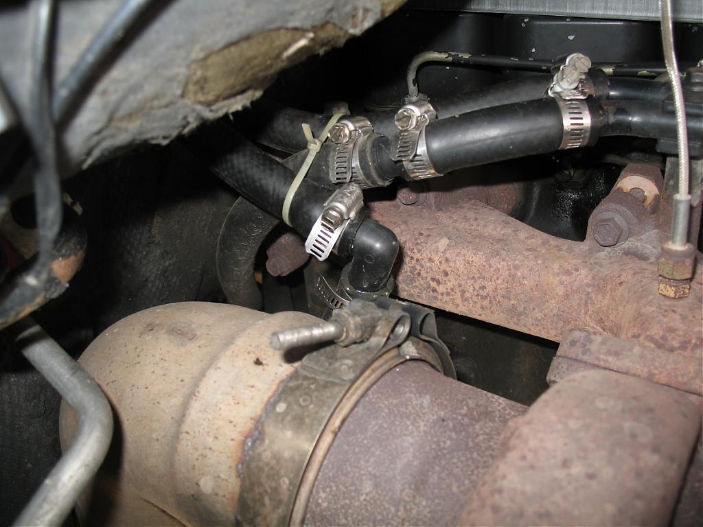

Its hard to explain in words...
This tiny picture is from the espar site..
The heater hose coming from the engine to the heat core - Webasto - core . The return line from the heater core goes right back to the block.
I have a picture of my 97 install. The elbow is the connection from the Espar heater to the core and the other connection is the feed from the block.

Makes no difference. The coolant flows through the heater core at all times, no valves, nothing, unless you have installed a valve.
