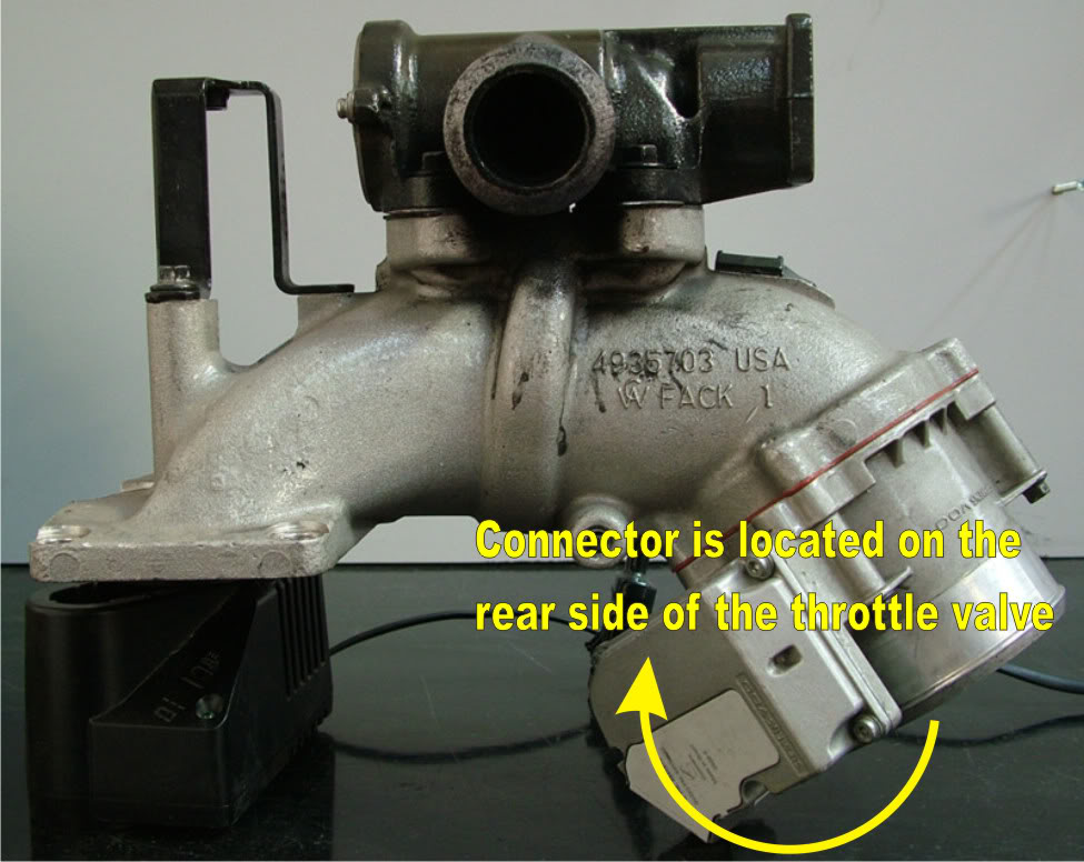

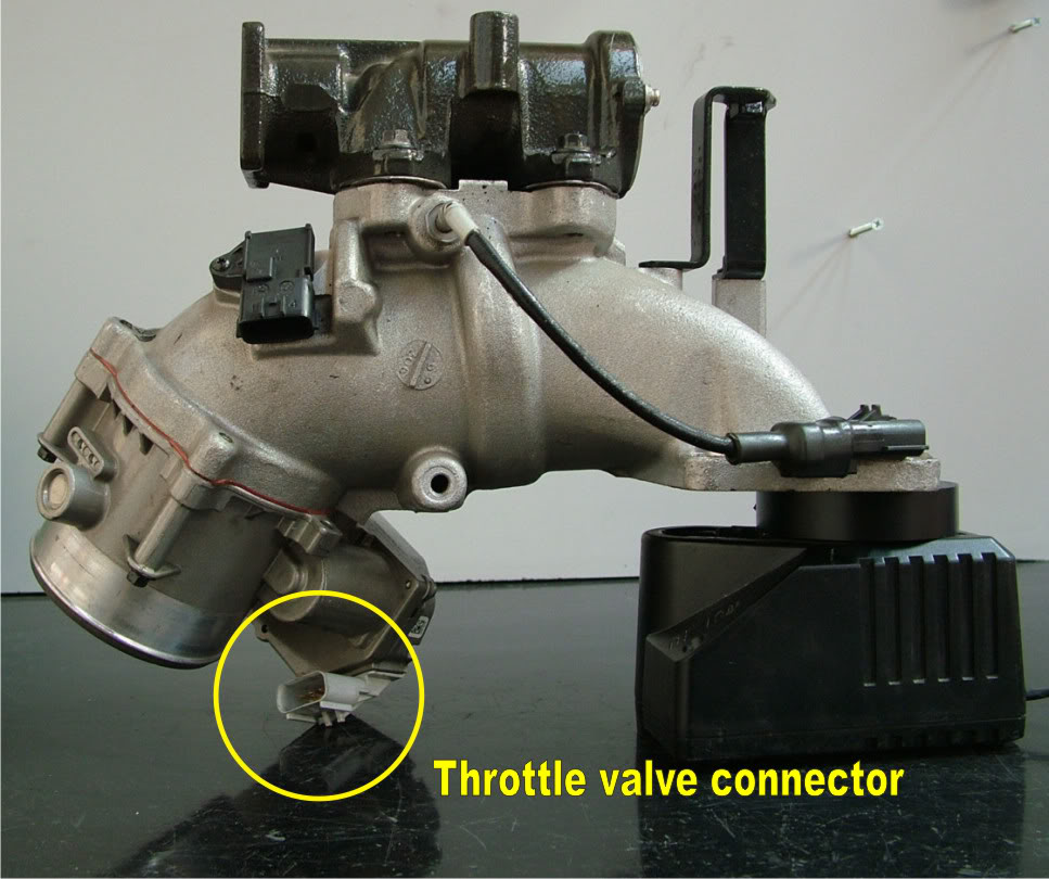

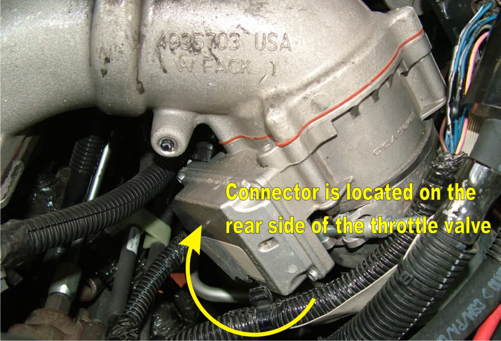

Blake Clark's Avatar
Posts: 5,491
Likes: 15
Originally Posted by EverydayDiesel
Im not sure about the TV. heres what I did when i installed the smarty jr ME
1. I removed the erg assembly and installed the egr block off plate.
2. Then I removed the egr motor from the assembly and plugged the motor back in and tied it up.
3. Then i removed the egr tube and installed the block off plate.
4. After that I unplugged the cooler on the left hand side
If you are running the ME software you should also unplug the throttle valve
Pictures courtesy of MADS website.

So your thinking that throttle valve is my problem? What exactly does that do?
No way its the actual butterfly valve for the intake? If you unplug the sensor how would your truck be able to move?
Old Jun 4, 2010 | 11:56 AM
Posts: 5,491
Likes: 15
Should default to the open position.
BTW, as far as I know anyway...
Throttle valve
Throttle blade
Butterfly valve
All the same thing......
