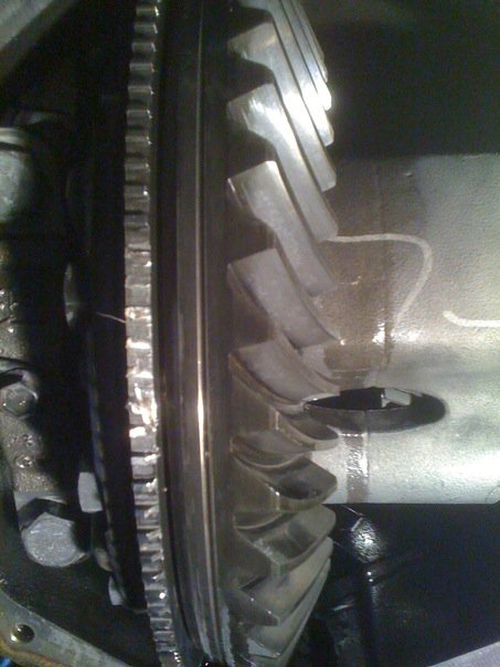

found the problem... now just have to find a new one.. i spent almost 2hrs trying to find the cause of this and i couldnt find a single thing.
Attached Thumbnails whats the deal with my brakes? any ideas?-kyle-rearend.jpg

Good going cbrahs!!!!!

$85 at the local dealer... ive looked online and called randys ring and pinion but no luck with either... anyone know anywhere else i might be able to get one?

stupid question....How did that cause your issues? not sarcastic,,,just a dummy here...

never mind, I read up on the tone ring...

Wow, any idea what caused the damage?!?
