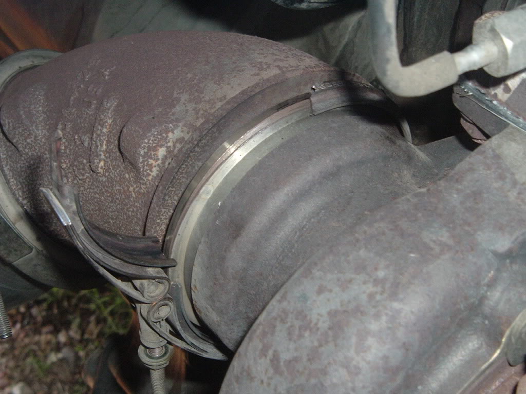

What do you think, can that be welded??? Thanks for all the replies so far....

Rick a good TIG hand could fix that for you, but it would only be a temp fix. That thin of metal with that heat applied would just fatigue again.

Shame you are so far away I could tig that no problem to get you going till you could get a new one.
