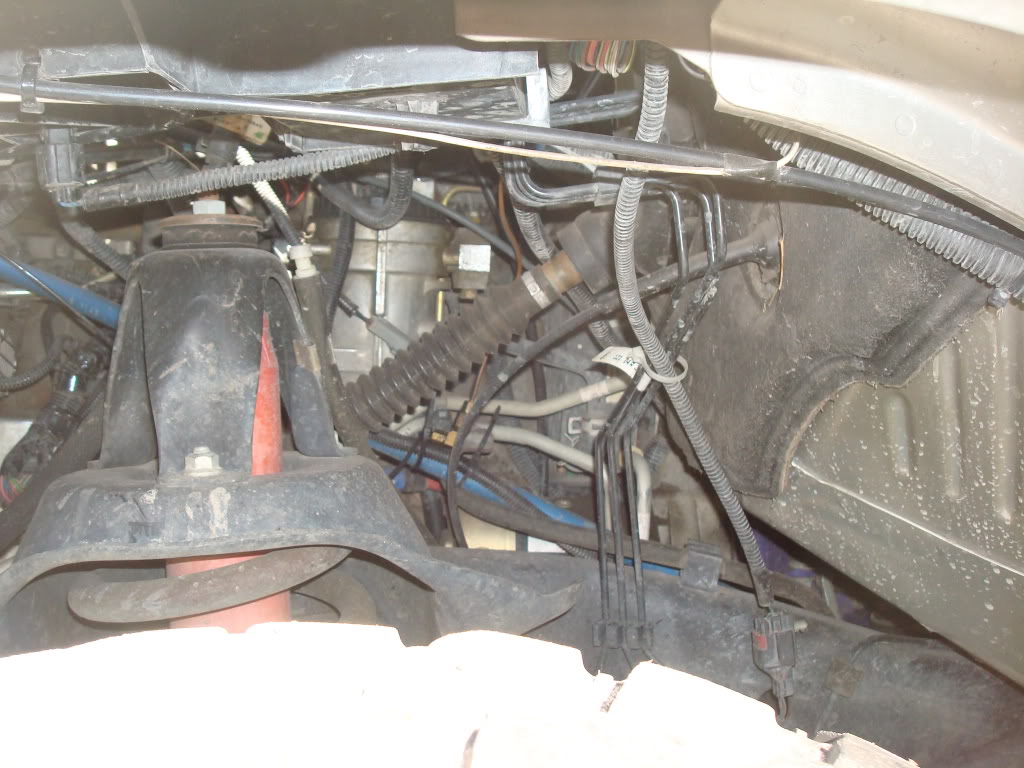

Below is a shot of the stock fuel filter canister, on the back where the silver piece is, that is the stock pump location. If it's there, you can bet it's bad.
When the pump dies, that's it. She can check for 12v at the pump, but it's probably toast. If you want a fairly easy fix, you can order an OEM replacement from Geno's, but I would spend a couple of extra bucks on a Raptor 100 for the ease of install, or an Air Dog 150 (or higher) if you're going to pay someone to do it.
