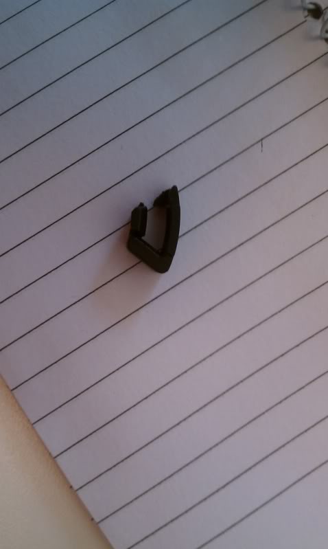

I just dropped the pan and found a little black plastic piece in the bottom of it. I'll post pics up in a second. I got it to go into park by slightly pushing in the plunger with my finger, seems to hang on the piece that plunger hits that attaches to the sift leaver.
Old Aug 7, 2010 | 01:18 PM
Seelow's Avatar
Posts: 85
From: Amsterdam, NY
Here is the piece what is it? looks brook off on the one side
