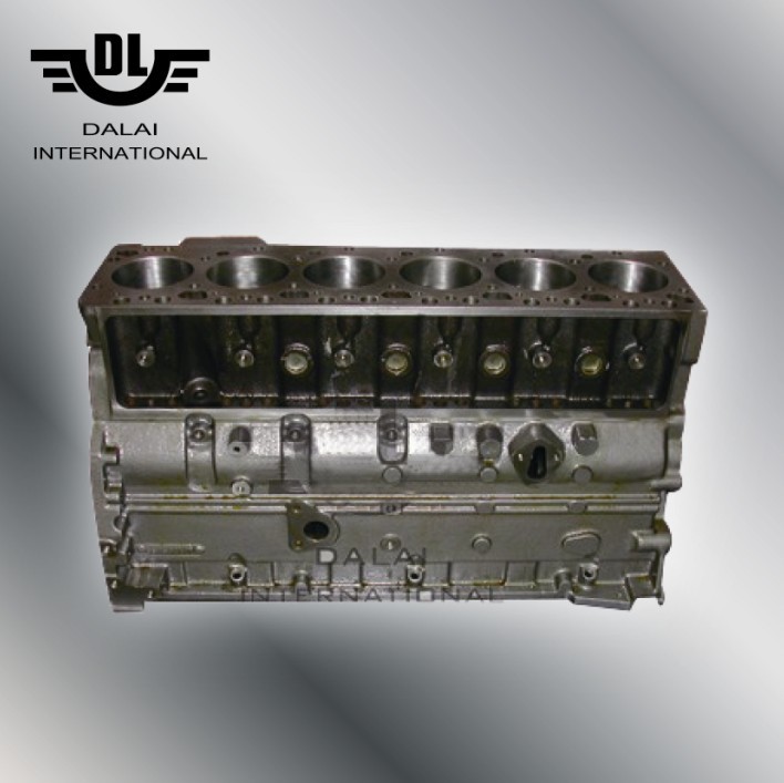

dont know if this is going to wokk but will give it a shot just above the fuel pump boss is the place that the cover go's

Originally Posted by Adaminak
Does the CR block have a tappet cover? I thought that went away sometime during the 24 valve era?
tappet cover still there
