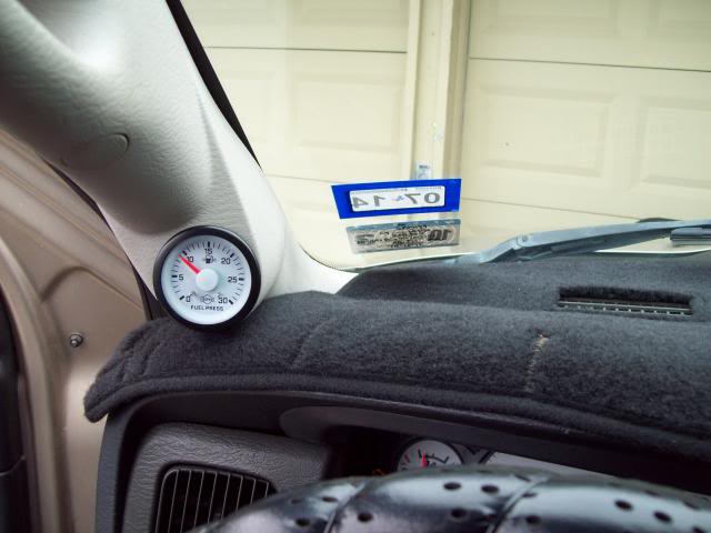

Old Sep 30, 2015 | 05:11 AM
Jbremount's Avatar
Joined: Aug 2011
Posts: 65
Truck in signature, fuel pressure at idle with stock in-tank fuel pump (the stock fuel pump has no problems delivering fuel through all the filters)
