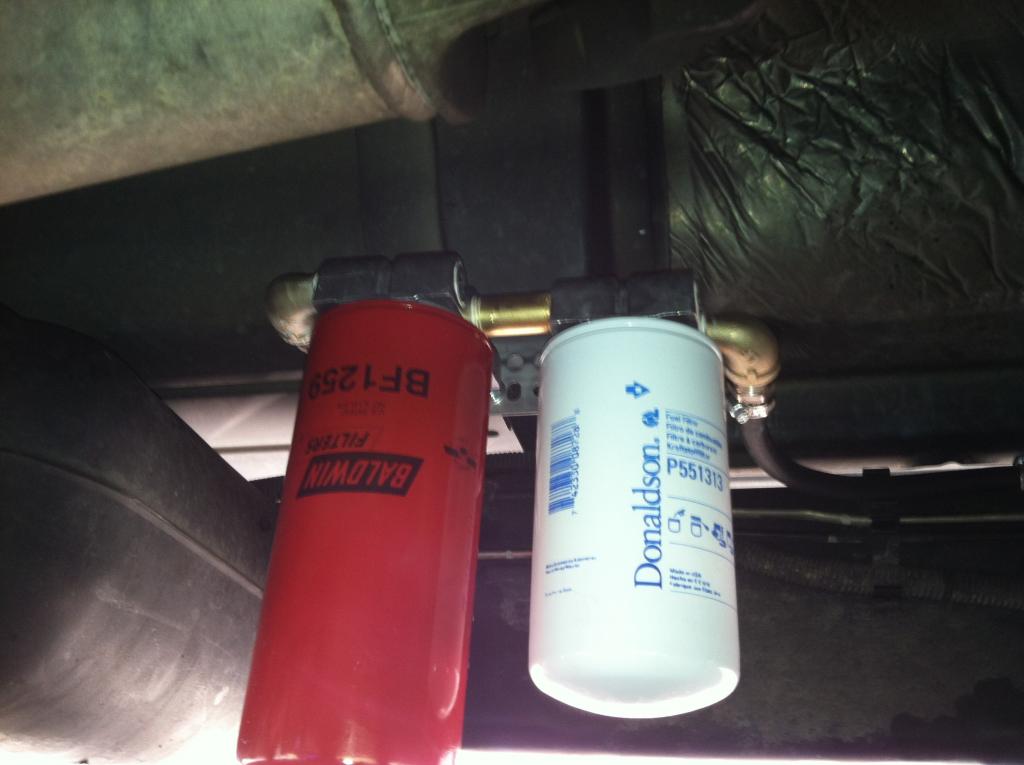

Here is my detup
Here is the final. It's been inline for the past two weeks and all seems to be A-OK. I do like the first filter being the Baldwin BF1259. However with the truck being a 2wd, it hangs lower than I particularly care for. Haven't found a equivalent shorter one. Thanks Carl and John for the suggestions.
I'm using water separator, Wix 33439 (usafilterstore.com, $10.67), which is about 1 1/8" shorter than your BF 1259. Just a thought.

Nice job!
