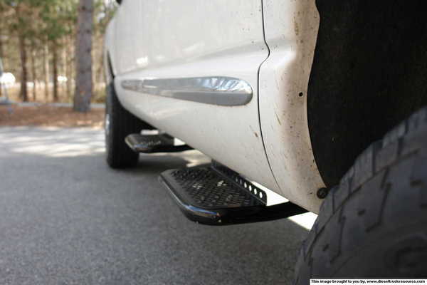

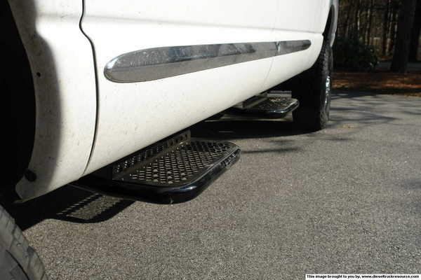

I REALLY like my CARR SuperHoop steps shown in your first post. Nerf bars bend to easy if you get off the pavement and N-fab bars are nice, but only for the man with deep pockets. I bought 2 sets of Super Hoops off Ebay from different sellers. They are both the older mount style, but I made them work and nothing has come loose in a year and a half. I spent $85 total, compared to brand new ones for $280 (2 pair) or N-fab's for $400-500.
Let me get a picture of them posted before you decide.

Here ya go---steps are pretty dirty.

ID,
Those look nice ....
How are they mounted....?
Old Feb 6, 2007 | 05:33 PM
ID2500Ram's Avatar
Posts: 73
Since my Carr Super Hoop steps don't have the newer universal mount, I used a stainless bolt through the pinch weld and stainless screws into the back of the rocker panel (2 bolts, 4 screws in each step). Since the back of the rocker panel is not vertical, I used washers to shim the back side of some of the screws, but it worked good.
I think the newer mount only uses 4 screws per step.
