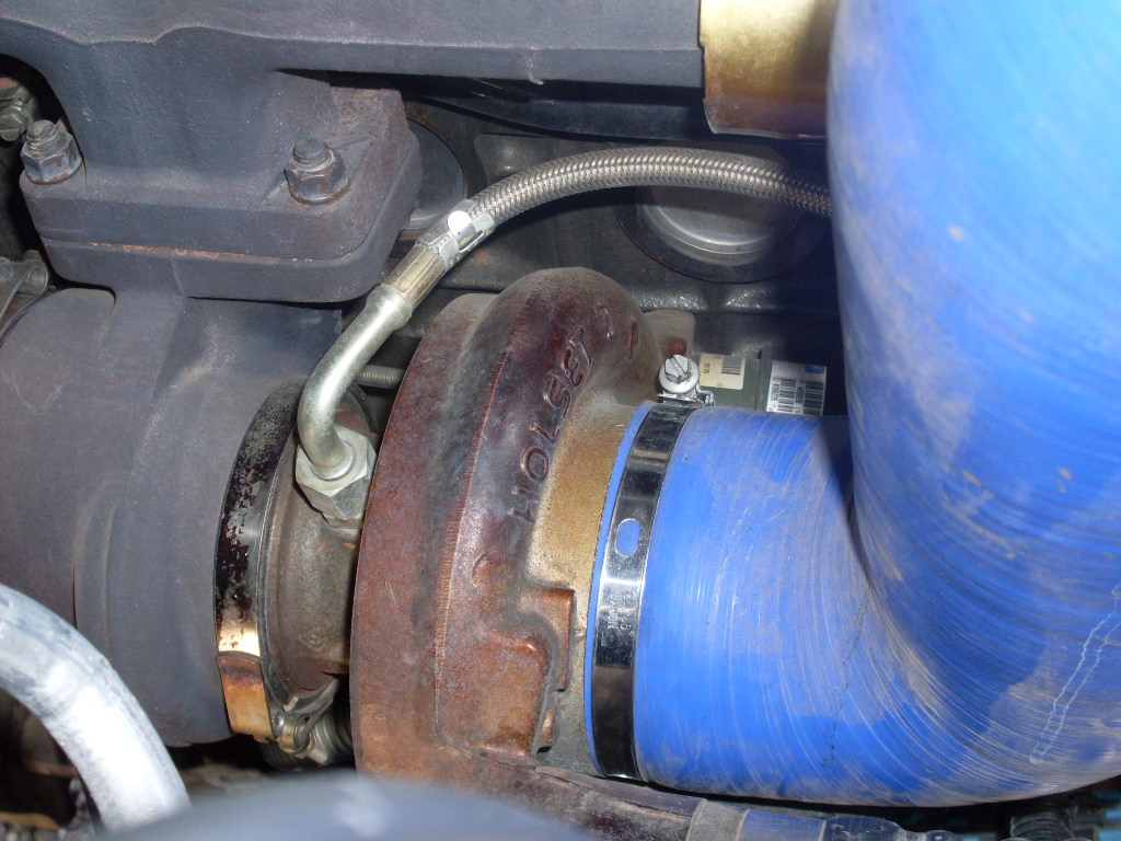

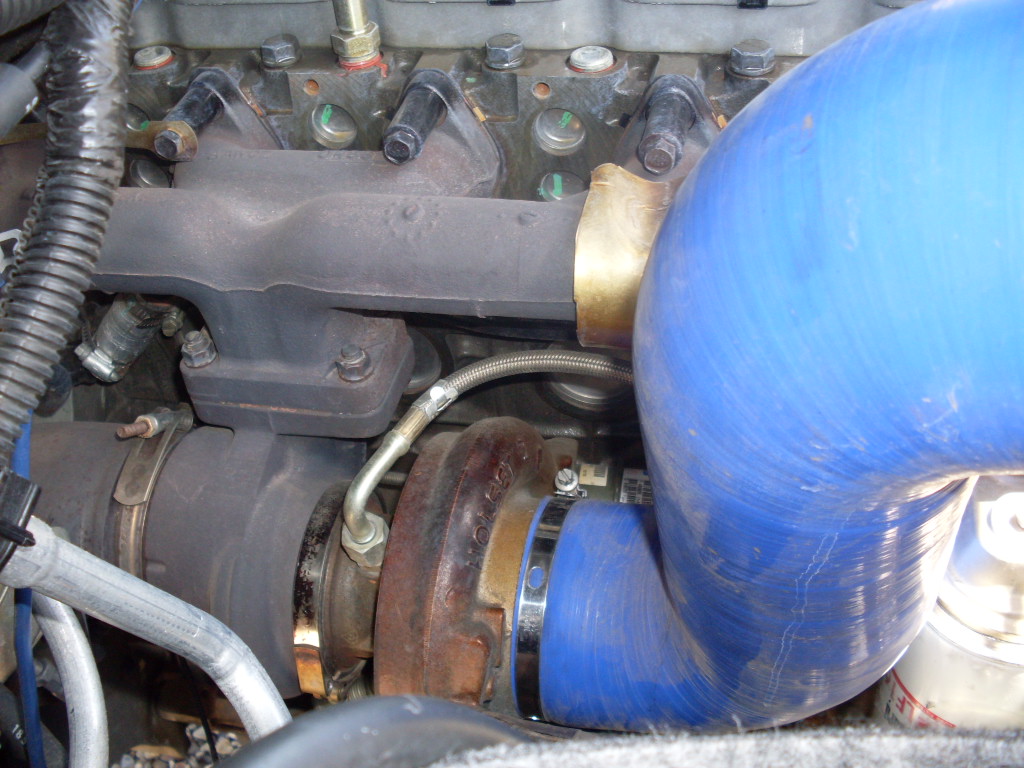

Just got back from Utah towing my 42' toyhauler with a Jeep Unlimited in the back, approx.20klbs for 2500mi. and noticed my turbo is kinda purple in color, Yes I have gauges and ran 1150 degrees max on pyro, post turbo in jake brake per Cummins, Cummins told me I can run 1150 Post turbo all day with no worries. I have 25k miles on the truck. Is this normal for the heavy towing guys?

sounds a little hot to me. usually 350* cooler on post turbo vs pre turbo.

sounds just like mine. my turbo is the same color. and my pyro is in the same spot. I have seen as much as 1300 on mine.

Holy crap! 1300 POST turbo? thats between 1500-1600 Pre-turbo...
Wonder if the pistons look mushy...

popeyes do you have any pics of your turbo now so we can see what you are talking about.

I'll take some pics in the a.m. and post them.
