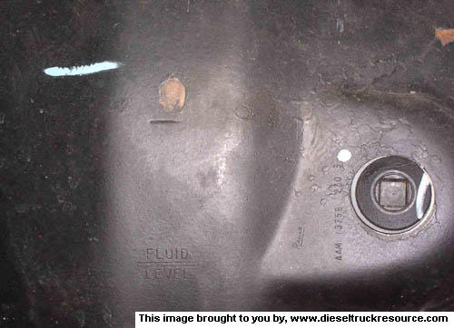

Tfeore's Avatar
Posts: 414
From: Glendale AZ
This is what the cover looked like before I went Mag-HiTek. I'm pretty sure your 04.5 and my 04 have the same covers
Tom
Old Dec 24, 2005 | 04:39 PM
Bad Ramer Jamer's Avatar
Joined: Jun 2004
Posts: 1,041
From: IL
I guess a picture truely is worth a thoushand word's. I see the fill line now. Thank's.
