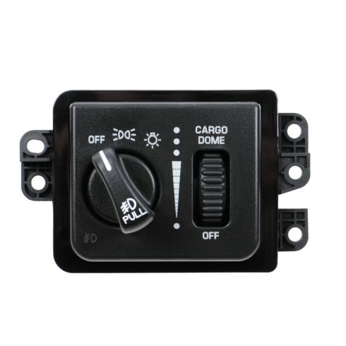

Where exactly is the switch for the fog lights. I thought they came on with the light switch. I don't see any other switch but I do have them in the bumper.

You may not have the switch with the fog light setting. Fog lights come on when you put the headlight switch in the parking light position (in the middle of off and on). If the truck came with factory fogs that should already be programmed. If adding fogs to an unfog lit truck you may need a switch and update the tipm.
Turn your lights to park or ON, then pull the **** to turn on the fogs....
