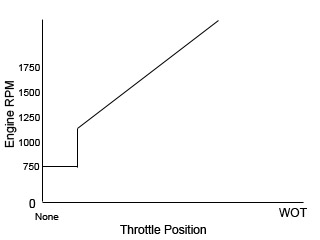

2004 2500 with 6 speed 21k miles... Have a problem with the throttle, best
way to describe it is is to include the attached graph that roughly indicates
how the engine rpm responds to throttle pressure.
The rpm will go from 750 directly to 1100-1200. You start pushing it
slowly and keep pushing and pushing and pushing rpm rock solid at 750
and BAM! all of a sudden it shoots to 1200.
This cannot be the correct behavior! This makes shifting and low speed
operations quite jerky. I guess an automatic you woudn't notice
it so much but with the six speed it is very unpleasant, and feels like it
it needlessly beating up my drivetrain.
I saw some posts from long ago mentioning calibrating the throttle
somehow. Would that help here? Is that the problem? Or is it time
for a **ealer visit? It's done this from day one just haven't really had
the time to pursue a resolution.

Doesn't sound like correct behavior. It won't hurt to try an APPS reset, but more than likely you are in for a trip to the dealer. Instructions for resetting the APPS are here: https://www.dieseltruckresource.com/...n&onlynewfaq=1

my truck does exactly the same thing, although if you let off very very softly you can get it to idle slower. When driving I can hold any rpm from 750-3500, it's just when the truck is sitting still is when it's hard to get any rpm between 750 and 1200.

You both need new TPS assy's.

Really? It is that bad? Not looking forward to convincing the blockheads
at the dealer that there really is a problem...
Will try the recalibration procedure first... maybe it will help a little. Nothing
to lose by giving it a shot! If not, off to the dealer I go....
