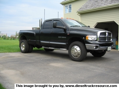

Nice looking ride. Just curious why change? I suspect a spouse issue here.
