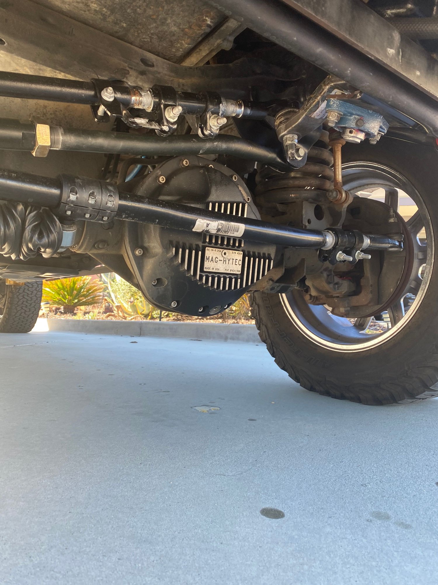

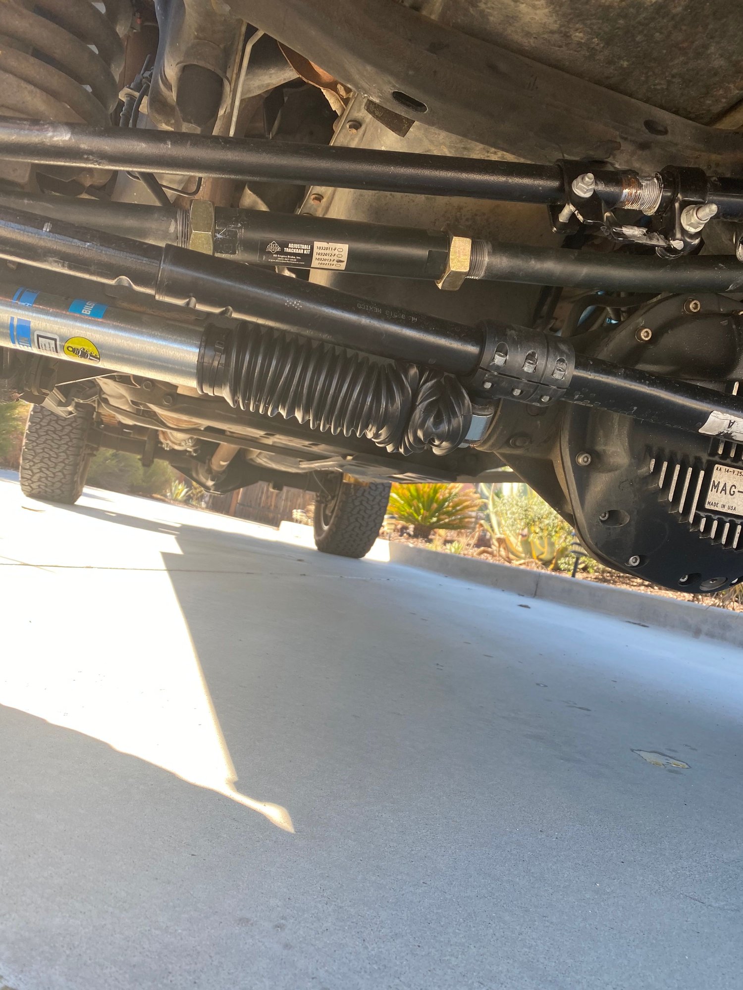

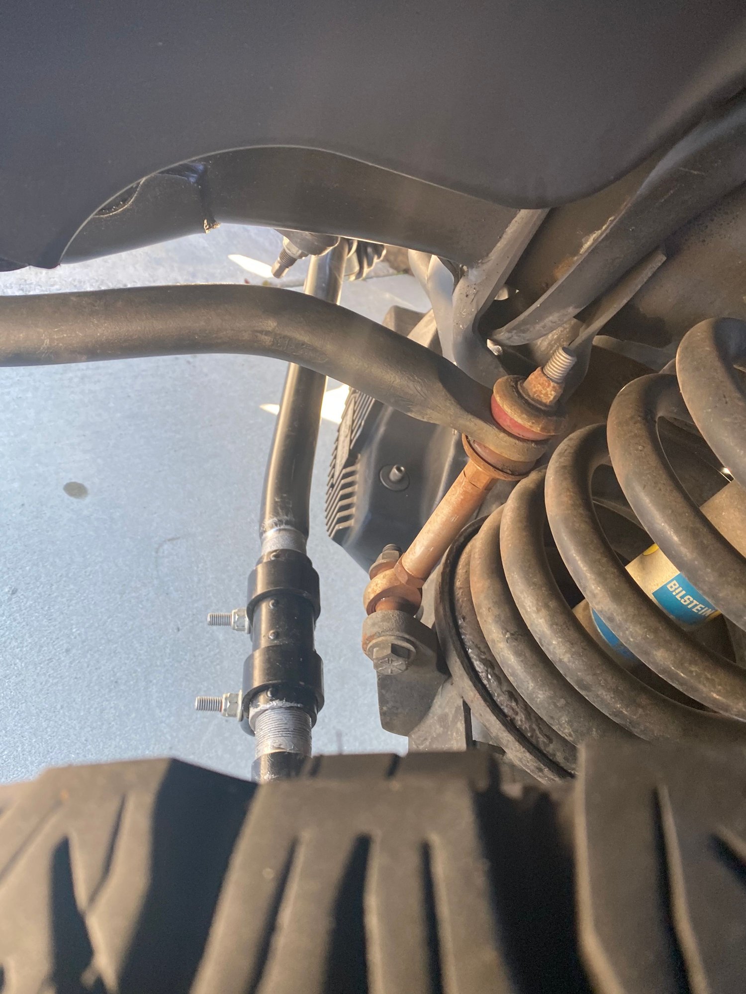

I have an 05 with 22.5 Alcoa's, a factory replacement Bilstein steering damper, and soon to have a 2.5" front leveling kit installed. I just purchased a 9.25 MH pan for the front. Does anyone know if by now has MH addressed and fixed the clearance issues? Again currently all the stock 2005 steering components except the Bilstein damper. Will I have to clearance the fins to install? Thanks
Old Feb 25, 2021 | 03:18 PM
vrj's Avatar
vrj
Posts: 226
From: Earth
On my 2005 Dodge Ram 2500, I have the rear diff. MH cover, trans. pan and front diff. cover previously installed. I recently updated to a BD Track Bar, Red Head steering box, and Mopar 4th Gen. steering upgrade. I upgraded the steering dampner clamp that bolts on the Mopar 4th Gen. steering bar to a Thuren Fabrication steering clamp mount (1.57"). I adjusted the placement and it clears the MH front diff. cover. I also have a steering brace previously installed. The original 4th Gen. Steering upgrade clamp hits the MH front diff. cover which is why I replaced it.
I did not file or shave any fins from my front MH diff. cover. The key to good clearance, as mentioned above was the Thuren Fabrication steering clamp mount (1.57"). I took pics and will upload them once I figure out the pics upload process. The dampner steering clamp link is listed below. I decided to give you all an update on my setup since I have been investigating the clearance issue from some time on other posts without any answers:
STEERING CLAMP MOUNT (thurenfabrication.com)
