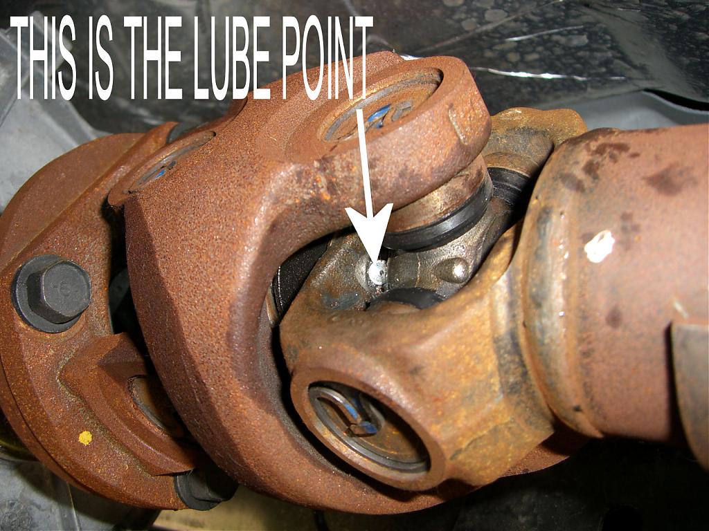

I looked at my front drive shaft and couldnt see anything to grease. what are they talking about? it says in the manual that it needs to be done pretty regular. thanks

They have the fitting there on all of the new trucks, and there are a few threads that show what you need to be looking for. Looking just behind the front ujoint on the double cardan coming from the xfer case to the front diff, if you rotate the driveshaft, you will be able to see a small circular plate with a hole/spingloadedball in the middle. Get a grease gun w/ needle attachment and get to work. Incidentally I always seem to break the needle each time I do this since it is hard to snake the grease gun into position.

Somebody else originally posted this photo, but here it is again. The location is tough to find (it helps to jack up a front wheel and rotate the tire/driveshaft).

The picture makes it look easier to see then it actually is. It is REALLY hard to see, but it is there if you have the sticker. As said above, jack up one front wheel and slowly rotate while looking up into the joint. Cleaning away any dirt helps also. It is just a small, shallow, cone shaped depression in the metal.

i said the same thing. i went a bought a florecent work light for this task. lifted the front wheels off the ground adn rotated the drive shaft until i actually saw what is pictured in the photo. i have been under the trk 4-5 times prior and missed it. i know now what to look for.

as mentioned earlier, get the needle vs the other type(tappered end) grease fitting. that thing was soooo aggrevating .
the needle(Plews Lubrimatic #05-037) worked like a charm. got it from oreillys
