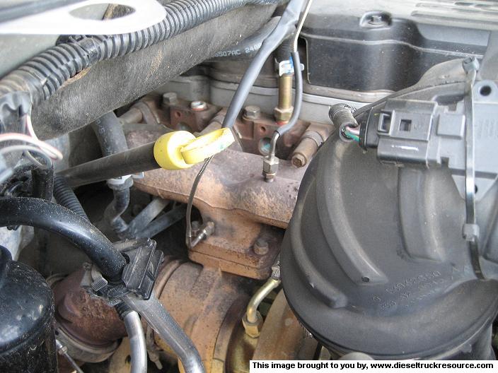

Where is your pyro probe installed?
And what temps are you seeing when you say it stays hot/warm while cooling down?
Also, free flowing exhaust will help out some, but depending on where your checking the temperature, it may always read hotter than others are seeing...
Heres where mine are, the one on top measuring 1-3 is for the edge/attitude, and the one in the "collector" portion is measuring 4-6 on the pillar. 4-6 runs hotter than 1-3, and laying into it some ill see a 50*-100* difference between the two...

stacked, my probe is a little above yours in the collector, from the time I park the truck temp in the 550 range it takes a good 3-4 min to get to 400

Well, from where you said your pyro probe is, id say it will read at least *50 higher than others are seeing...
