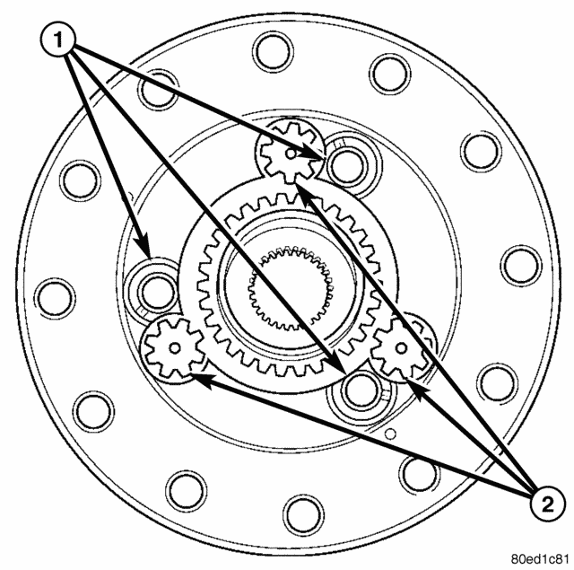

I can't for the life of me figure out why so many have convinced themselves that this helps there truck! LOL There are NO clutches in the 3rd gen AAM axles. Maybe some are referring to their 1500's or something? AAM is the OOONLY axle available in the rear for 2500 and 3500 trucks! No additive required at all. NADA! ZERO! ZIP! If you don't believe me....call your dealer with your vin, figure out which axle you have in the rear, and which limited slip you have. Here's a chart to follow once you have all that info.
AXLE
NOTE: DaimlerChrysler recommends using Mopar® lubricants or lubricants of equal quality.

NOTE: Trac-Lok® differentials require Limited Slip Additive in the lubricant. Trac-Rite™ / Trac-Rite EL™ differentials DO NOT require Limited Slip Additive.

OPERATION
CAUTION: The differential is serviced as an assembly only do not attempt to disassemble. Failure to follow these instructions will result in damage to the differential.
When one wheel begins to spin the pinion gears (2) on that side, are forced toward the pinion brake shoes (1). The pinion brake shoes then cause frictional drag on the opposite pinion gears and the side gear. These friction forces transfer the power to the opposite wheel. Once the frictional forces are overcome, differentiation will occur. The torque will be continually biased by the frictional forces to the high traction wheel.
