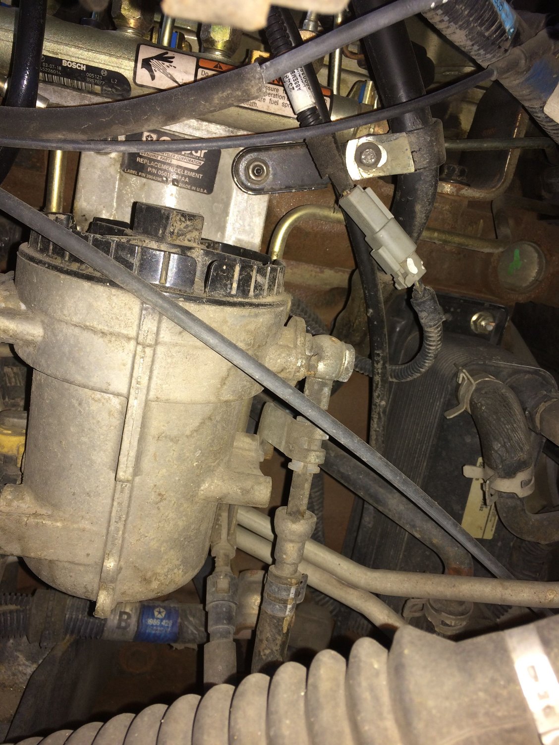

Ok I really feel like a newbie again. There is no lift pump on the filter housing. I do believe what I'm hearing is an electric vacuum pump on passenger firewall.... I took a pic but can't figure how to post from iPhone. Anyhow banjo fitting to hose is all that's there. The plug from the original lift pump goes to a relay on the firewall then back to tank... Sorry guys.... Now do I need to monitor fuel pressure with this 5.9 like I did with my 98? Does the in tank pump push enough fuel to support a small programmer? This truck needs gauges bad lol just don't know which ones I need?

Old Jul 22, 2015 | 01:43 PM
NJMurvin's Avatar
Posts: 983
From: Simi Valley, CA
Your pic looks a lot like mine after the in-tank upgrade. If the wire goes to the tank, then that's another clue. I assume you would see if a third-party pump (e.g. Airdog) was installed. An in-tank pump should support a mild programmer. If your noise is coming from under the dash and the lift pump is in the tank, I doubt that the lift pump is your issue. Experts need to chime in here.
