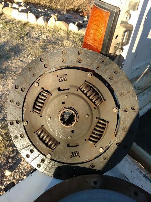

I installed the SB 1947 OK-HD. I used a floor jack under the front of the engine to use a little lift on the front to help the shift tower clear the floor pan. I used a semi trans jack which made the job really easy, as long as you have a good jack it will go pretty easy. My throwout bearing went at about 120,000, my clutch and pressure plate were in great shape, no hot spots or marks, and never slippped. If I had not already bought the SB clutch kit I would have just replaced the throwout bearing. The pictures are of my stock clutch and flywheel, the marks you see on the flywheel are finger prints.
