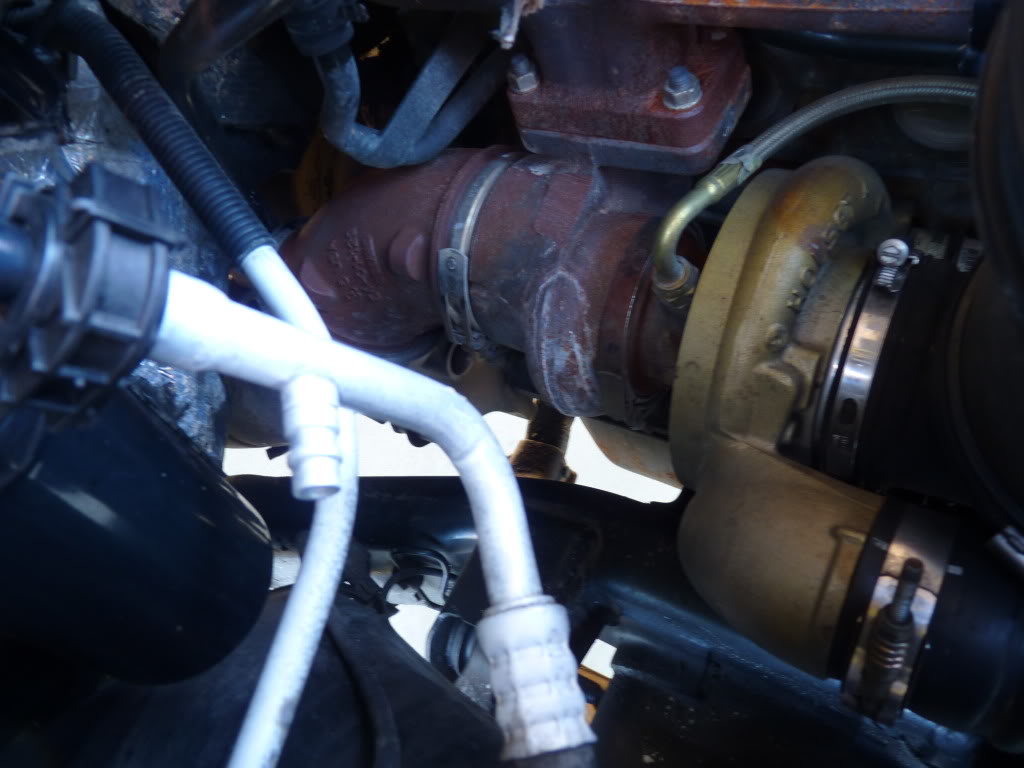

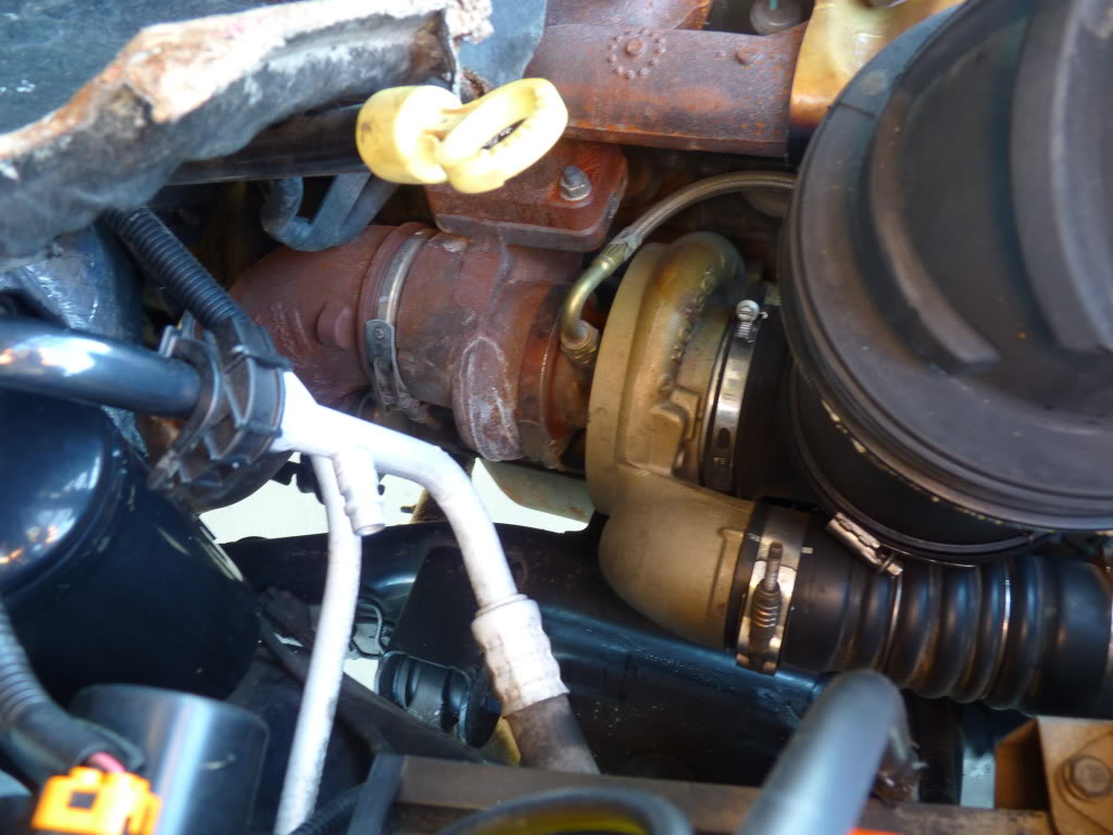

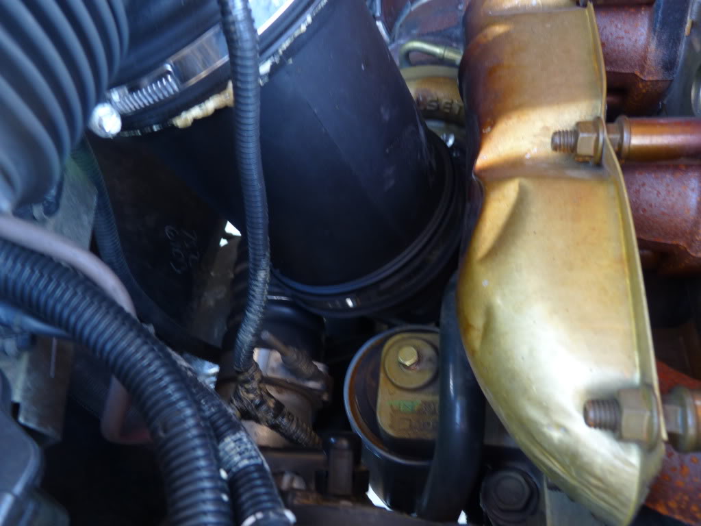

Well it is a good looking truck. I noticed there is a seal missing that is suppose to go on the flat edge of the metal right above the wore loom and below the edge of the insulation pad. With that gone, it can make your windshield fog easier, as the heat from the engine is drawn over the windshield. The seal stops that. Otherwise, it looks good.
Old Jan 5, 2011 | 03:49 PM
bigdaddy51200's Avatar
Posts: 41
I have no idea what your talking about , whats it called and where can I get one .
Old Jan 5, 2011 | 04:02 PM
1-2-3's Avatar
Just a plain ole guy
Posts: 2,537
Likes: 11
From: Carlos, Texas
Look at your third picture. At the top of the engine bay, where there is a 4 inch or so wide piece of insulation pad, there is a flat edge of metal. Below that flat edge of metal is a black hose looking thing that is really a covering over some wires. There is suppose to be a rubber seal that pushes onto that edge of the metal to keep engine gasses and heat from fogging the windshield. Also when you set your ac to get outside air, it will be getting heated air from the engine without that seal. Look a a few engine pics on autotrader dot com and compare. You'll see it. lmctruck dot com is a good place to order stuff like that from.
Old Jan 5, 2011 | 04:08 PM
1-2-3's Avatar
Posts: 2,537
Likes: 11
From: Carlos, Texas
Hood to Cowl Seal is what LMC is calling it. It's on page 10 of their catalog, part number 56-5200 however they are only showing it for gen 2 trucks, not gen 3.
