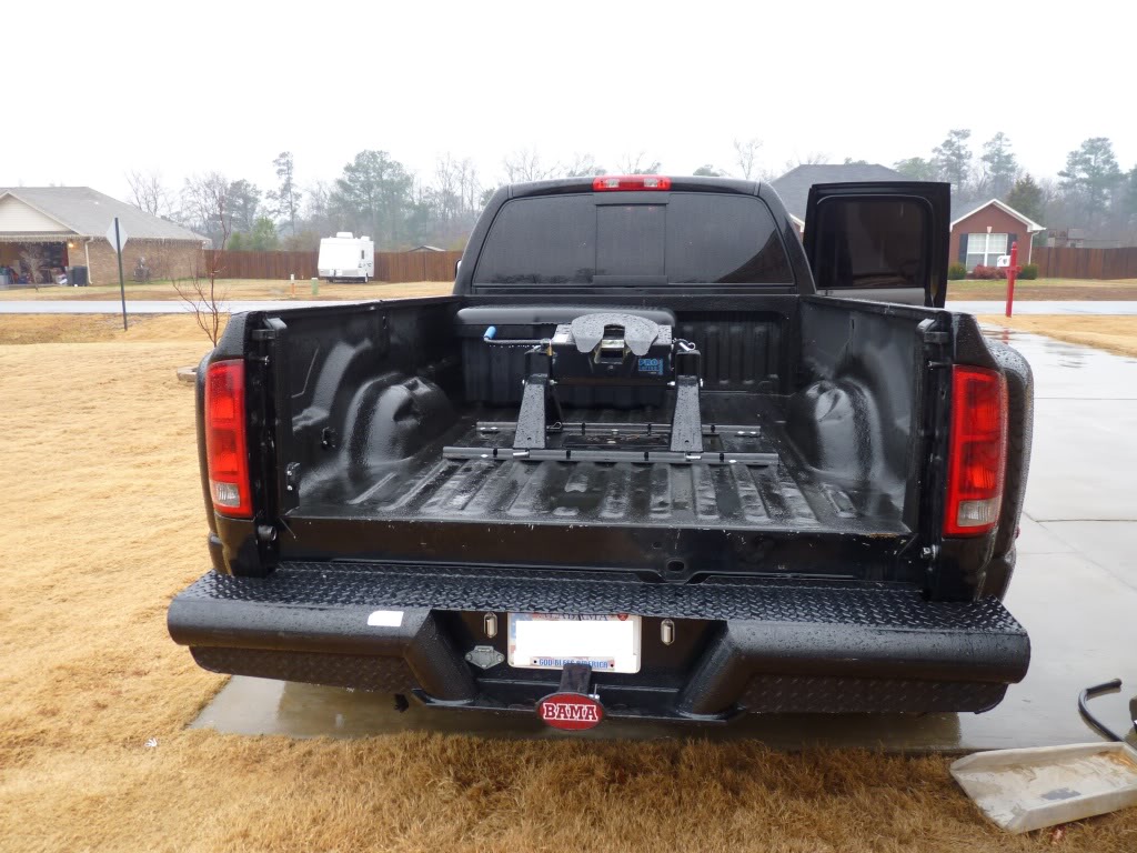

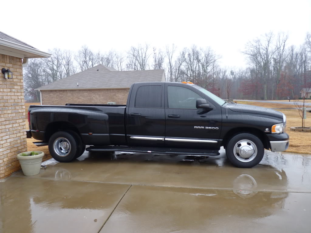

No they didn't say it had a engine swap . It's not my daily driver , I just bought it to pull my 39ft 14,000 pound 5th wheel . here is a few pic's of it .
