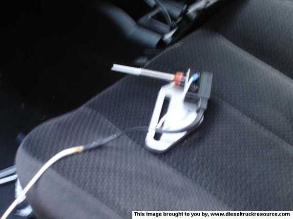

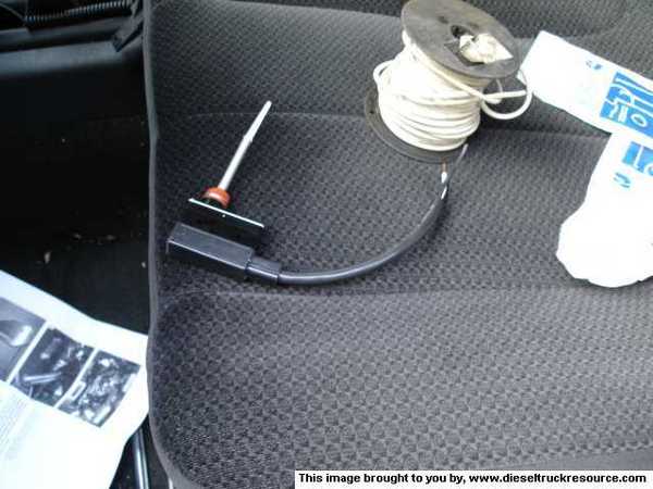

Originally Posted by Hercules130
I had had the switch installed on mine, pretty easy, just need to be comfortably plugging into the ecm. They then can activate using the DRBII.
Where did you buy the switch? Can this be done on a 06?
I got it from Lou Fusz, Cuz Tomeygun gets us the TDR discount.
Old Oct 6, 2006 | 06:57 AM
  #40
Hercules130's Avatar
Posts: 137
The dodge tech who does my side work said it was just a simple proximity switch like the big trucks use for the reverse sensing switch. So i guess if you got one of those, fabbed a bracket and got a couple of ECM pins you could save yourself $200.
NOTE: I think when you push the clutch in it actually disengages the switch.
