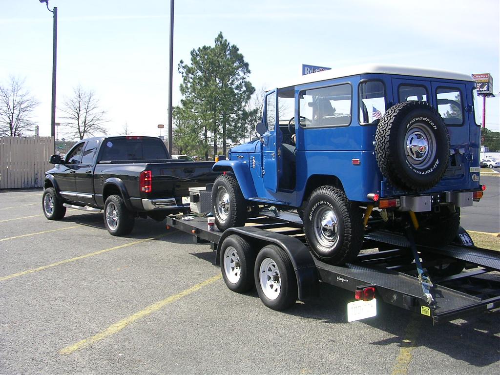

I recently went down to GA to pick up a truck for sombody and bring it here back to NJ. I have the predator and had it in the middle performance mode and i can tow up to 8000lbs. i have a 1500lbs trailer and the truck was 5000lbs. i drove from nj to ga in that mode and went i had the truck on the trailer i put it in tow mode.
not 30 min later i had no boost, black smoke out the wazzu and now power. i had just installed egt,boost,tranny guages the night before...there were no rips in any of the boots to the turbo...we did notice that under the truck/turbo was leakin oil slowly from a seal...it looked like a drain plug but imm not sure
