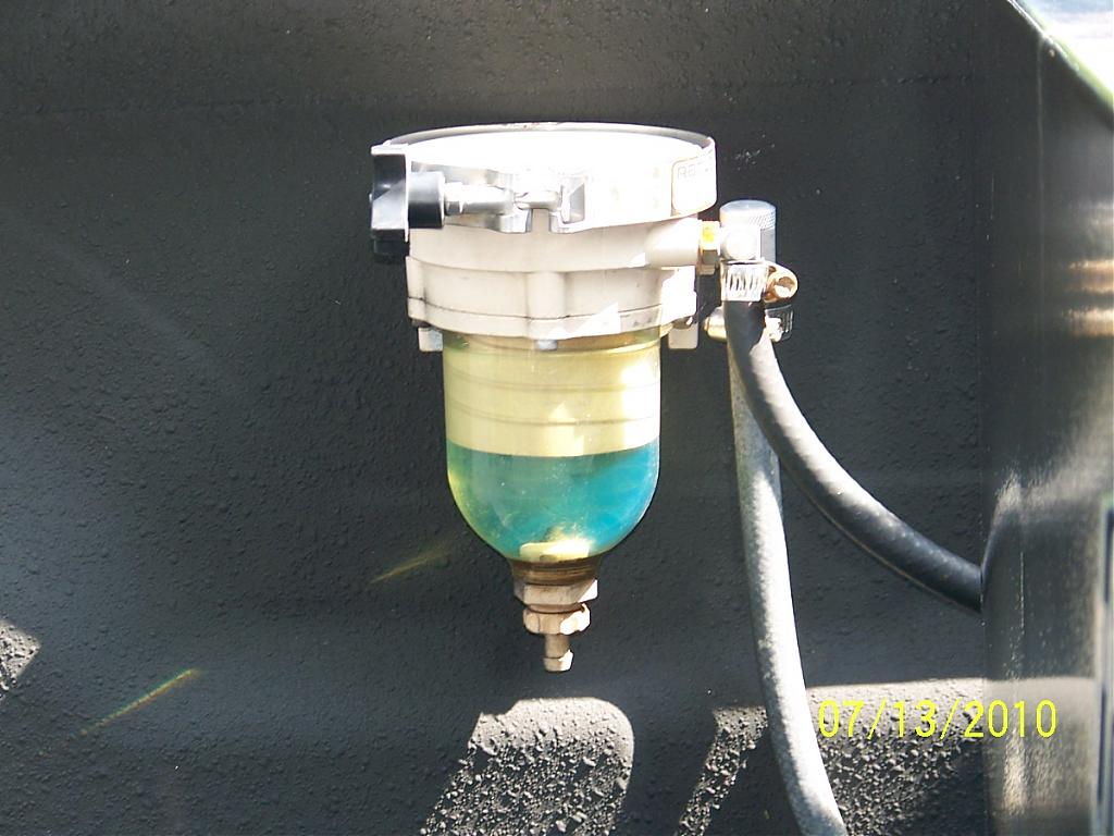

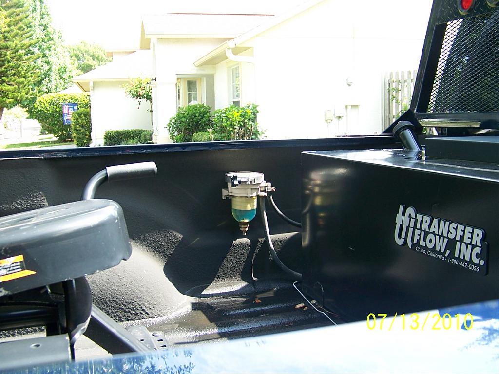

That will do the job. I have a Racor SM2000, older style, in the pump line from my 70 gallon bed tank. If your going to feed it or use it with an out of the tank pump, then its recommended you put it on the suction side of the pump and pull threw the racor.
I have put about 900 gallons thru the system to date, no water seen yet. I have some solids from the tank in the bottom of the bowl. You might be able to see them in the pic's below. Mine has a 10 micron filter in it so it does do a little cleaning before it goes to the trucks tank.
