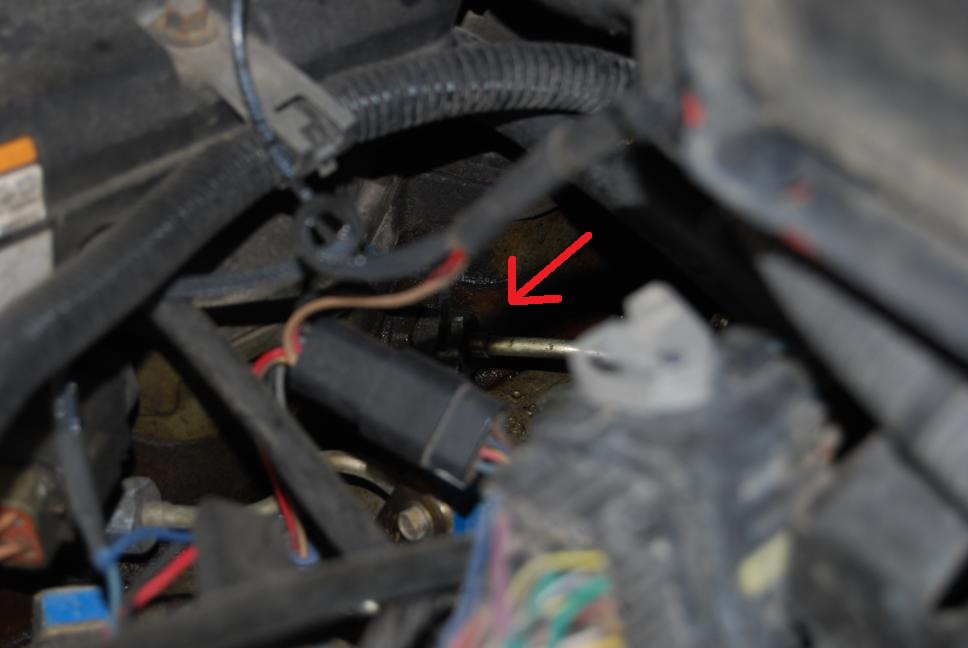

So I go to start my truck this AM....it takes a few more cranks to start than usual, don't think much of it. I catch a faint whiff of fuel smell, but not major. So I go inside for just a min to grab my lunch off the counter, and when I come back out I see fuel pouring down onto the ground. Pouring may be a slight exaggeration, but it was def more than a trickle. I quick shut it off, and am in a hurry, so I catch a ride to work.
Fast forward to tonight. I have the wife at the helm, and I check it out while she starts it up. Turns out, fuel is spraying out of a fitting near the back of the engine. I am way less familiar with these engines than I should be, so I can't even identify what the part is. Rather embarrassing, really.
So I have a few questions based on this situation. Looking at the pictures below, can somebody tell me what the part is? Or even better, is there an exploded parts diagram I can look at somewhere?
The fuel appears to be spraying backwards from where the nut meets the fuel line, or just behind there (spray pic attached as well). What would cause something like that to happen? Just age and corrosion, or is there something bigger happening here? I sure hope not....
Is that line as short as it appears, and is therefore easy to replace? Or is this something that I need to let an expert handle? I am mechanically inclined, so that's not a concern, just don't have the experience with this engine.
Thanks a lot for any help with this!
Attached Thumbnails Fuel spraying out fitting-tn2.jpg   Fuel spraying out fitting-tn4.jpg

That is an injector line. Be very careful, fuel can come out of that line in excess of 26k PSI. It is very dangerous!!!
I think that the #4 lines were prone to cracking. Search in the third gen section for injector lines, you'll come across it.

I can't tell from the picture, but is that the #4 fuel line? Count from the front of the radiator back fuel lines and tell us which one it is. If it's the #4 cylinder fuel line, they go out (split, crack, ect) all the time. I don't know anyone who hasn't had their #4 line replaced.
Should be under $80 for a new one, if that what it is. Good luck.

I went out and looked it over again, it does indeed look like the #4. Is it really just as easy as backing off the nuts (i assume based on the material, i should use a flare nut wrench), take off the old one, and put the new one in its place? Is there any sort of bleed process i need to do or anything?
Edit: oh yeah...anybody have a pn handy to save me a search?

Yes, old off, new on. I don't have the tq specs handy, tho.
No bleeding, it is a self priming system. You don't need a p/n, just your vin for the dealer. Better buy two.
