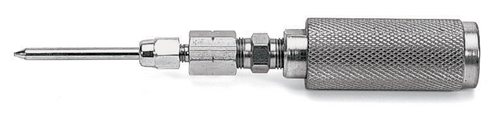

Here's what I use:
Attached Thumbnails Front Drive Shaft Grease Point. Iv read allt he posts I cant find it-17730.jpg
Old Feb 23, 2008 | 08:44 PM
J BODY's Avatar
Joined: Nov 2003
Posts: 3,654
I have a fitting similar to what torquefan shows. I did have to cut mine and rethread one end to make it work. It's a real biotch to get a good angle on that dang thing. I usually hit it with air to clean it and then "attempt" to grease it. Pretty stupid design. Bad thing is I know I'm the only guy in the shop that has this tool.

This is the hypo needle that I use. I push the needle hard enought to move the little ball out of the way and the needle slips into the hole.

Originally Posted by Fisherguy
The needle type isn't the right one cuz it won't 'force' any grease into the joint. I've bought 2 of the proper ones so far, but still can't get any to go in...
... yes and it's still not the right one.
You keep saying the correct one won't work and other guys keep saying the smaller needle one does work. I think I'll go with the wrong one...that does work!
