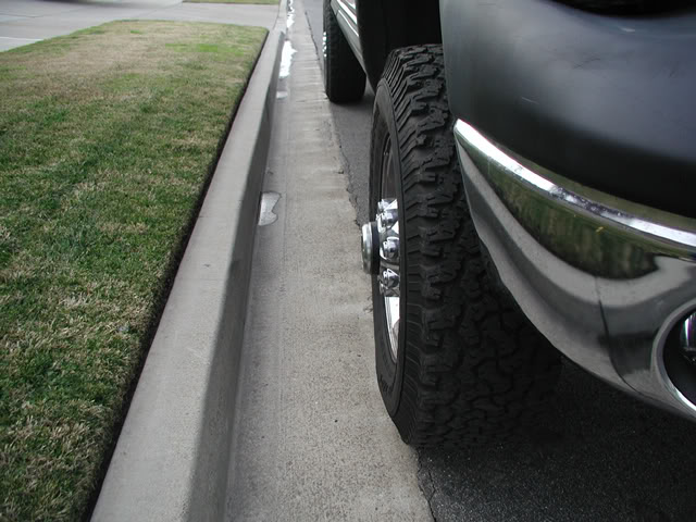

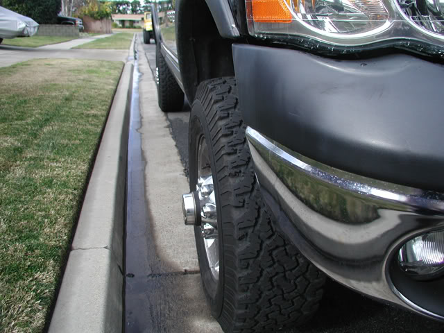

Well I have the upgrade Dynatrac Free Spin Kit which is called Dynaloc's and is about 3/4" shorter than the Warn's. Yes more $$$. So my pics below may not be exactly what you are looking for but maybe it will help give some useful info for you......

Thanks for the pics. The dynalocs look great, they don't seem to protrude beyond the tire. Guess I'll just have to keep saving. Both of the rides look good
