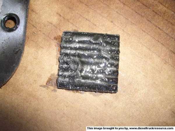

The magnet will just be sitting in the bottom of the case. I was able to just reach in with my fingers and find it.
Mine had quite a bit of metal mud on it (photo in my gallery) so I think it was worth while to clean it.
