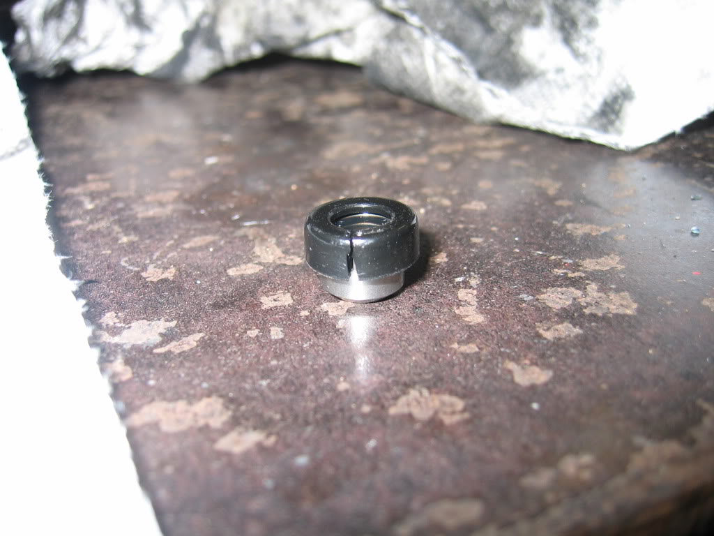

well to answer my own question here you go: rocker arm socket was cracked and i believe this caused the oil to be pushed out the crack and not through the lube port in the socket like its supposed to in order to keep oil between the crosshead and socket. Name:  IMG_7967.jpg
